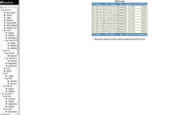

my login looks like this
Hi @Lennar010203
The web interface you have shared is of your Switch. The unleashed dashboard should look like the below screenshot. You could run an IP Scan and find the IP address of your Access Point to access Unleashed.
