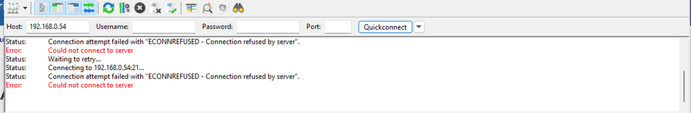

I am not able to connect to FTP, the connection is being refused. How can I fix it?
And when I try to log in with web ui it doesn't any provided user/pwd combination, how I can reset the user/pwd?

Hi @jag4645
Apologies for the misunderstanding.
Could you please share the screenshot of the FTP error you are getting during Upgrade process?
07-10-2023 02:28 PM
FTPTD I could not download and the link you provided does not work, site has many adds.
I use FileZilla which should connect too, I also tried with WinSCP that doesn't work too.
I got the same error for SSH on putty.
