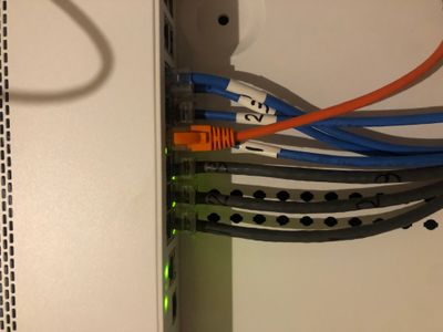

Need help getting ruckus staying connected after power outages. Have unplugged and plugged back in twice.

I wasn't logged in so I guess I could take a pic but here it is

Hi @Saustgen
As I see from the picture you shared, seems like the ethernet cable which is coming from the Router or Modem/Router combo is plugged into the wrong port on the Switch panel. It must be plugged into any 1 in-12 ports as shown in the below screenshot. Please unplug the ethernet cable and plug it into the correct port and check the connectivity. If required reboot your ISP (Internet Service Provider) Router and RUCKUS ICX-7150-C12P Switch once.
Please refer to the short guide link below about how to connect the devices as reference:
Please check, confirm and let me know if you have any queries in this regard.
08-14-2023 12:39 PM
I have moved the ether net cable and rebooted. Now the router is flashing red.

Hi @Saustgen
Router may take some time to reboot and come up.
Now we will check some configurations on the Switch, please follow the below steps to check the same.
ICX7150-C12 Router> OR
ICX7150-C12 Switch>
show version
show flash
