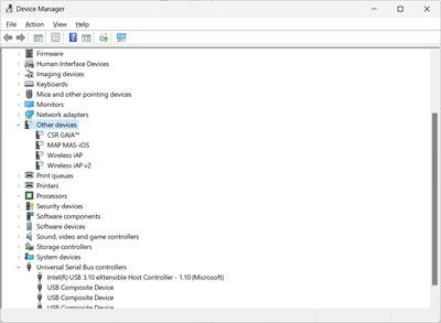

03-16-2024 03:23 AM
This is were we fail. I can not get to "Ports" on the "Device Manager"? Any help?
Thanks

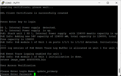

03-16-2024 04:52 AM
This is were I missed up now.
