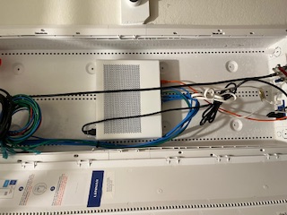

This is a repeated issue. The ruckus closes the case with no resolution. The unit is at my residence and by the time we receive a response I am at work. The same issue keeps repeating and the same answers I get, to reset.

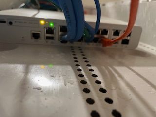

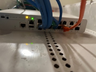

In brief, the unit gets to reboot mode every time we lose power. The STAT amber light is on and the POWER green light is on. There are five access points connected. This is repeated many times. My home network is not working for a few weeks. Please advise

I tried to reset it again. All lights keep flashing in Amber and it stays like this for a couple of hours. When it stops it goes back to the same booting mode. Please advise
