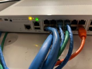

This is a repeated issue. The ruckus closes the case with no resolution. The unit is at my residence and by the time we receive a response I am at work. The same issue keeps repeating and the same answers I get, to reset.
In brief, the unit gets to reboot mode every time we lose power. The STAT amber light is on and the POWER green light is on. There are five access points connected. This is repeated many times. My home network is not working for a few weeks. Please advise

Hello, Imran - The switch is on. Exit the boot mode. After I connect the cables and re-power it is back again to Boot mode. Complete waste of time. What to do?

Hi @helbastawisy
As it is asking for the login username/password (refer to the below screenshot), please enter the same and then perform the software recovery process.

Actually, I did. Enter user name and password, below the posted picture. I finish, but when connected wires and placed it in place I enter again reboot mode. The problem as is, software recovery, did not work. Every time we loose power we enter reboot mode. Now what to do, reset ?
