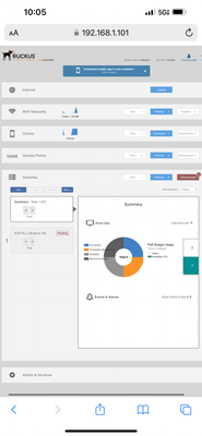

I have 2 APs. Both showing green power and amber 5ghz and 2.4 ghz. Master AP also showing green control. The WiFi has a different name when I set it up. I am able to log in to browser based gui. The switch is showing as disconnected on the gui.
02-09-2024 07:06 AM

02-12-2024 11:36 AM
It did not give me the login option. It said it could not auto locate the IP address of the switch. I manually entered the IP address of the switch and the system has been sitting in the connecting state doing nothing for over an hour. Please advise.
