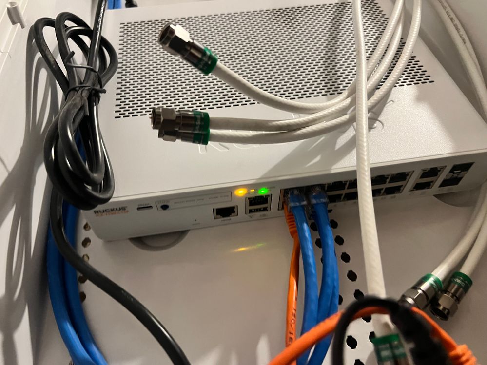

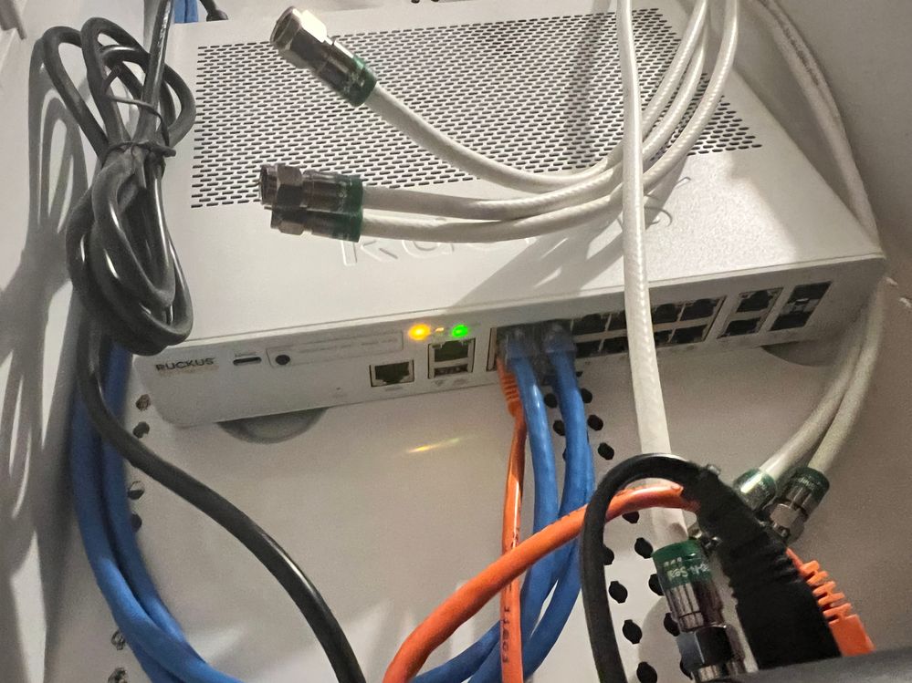

2.  On your switch while it's plugged into the outlet, do you see any lights on? (Amber or green) Please let us know which lights are on. (Please refer to the below picture and share a picture of the same, showing the light status and the FULL Switch panel cable connections to the Switch ports)

Thanks for your quick response. below find my update below,
1) There is no power outage.
2) I have attached the photos that i can take it in best possible condition.
Thanks
VRuckus_3.jpegRuckus_1.jpegRuckus_2.jpegRuckus_4.jpgignesh A

Hello @vasokan21 ,
From the response you shared, I understand that the status lights on the Switch is Amber and the PWR light is Green, which means that the Switch is stuck in a boot mode
Please follow the below RUCKUS Lennar Knowledge base self-help article which will help you to fix the issue when the Switch is in boot mode.
https://community.ruckuswireless.com/t5/RUCKUS-Lennar-Support-Knowledge/Fixing-RUCKUS-Switch-with-an...
Please follow the process as explained in the article and let me know if you have any queries in this regard.
