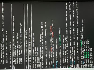

Hi. My Ruckus ICX7150-C12 is booted with Router firmware and I cannot get it to flash to Switch firmware. I read all the post and tried to flash the primary firmware and it looks like file was corrupted. I saw instructions to download and overwrite the primary firmware here Solved: RUCKUS Forums - Re: Ruckus ICX 7150-C12P - Page 9 - CommScope RUCKUS Community Forums (rucku... but I received error code 5 when trying to download using below both commands:
copy tftp flash 10.176.220.51 SPS08095hufi.bin primary
copy tftp flash 10.176.220.51 SPS08080f.bin primary

This may be because your switch may be running on the Routing code (SPR). The Switch should run on the Switching code (SPS) to avoid these issues for Lennar home users. Due to a power outage/power spike, the Switch boots up on the other partition which may be running on a ‘Routing Code’ results in causing this issue.
As I can see from the output you shared, your Switch may be booted up on the secondary partition which is running on Routing code (SPR) as highlighted in the below screenshot.
Please Enter the below commands in CLI to fix this issue:
copy flash flash secondary
Example:
VIDEO LINK AS REFERENCEhttps://www.youtube.com/watch?v=Eem1IBgYaWc
ICX7150-24P Router#copy flash flash secondary (hit enter to accept the command and wait: until the flash finished)
ICX7150-24P Router#boot system flash secondary yes (hit enter to accept the command: the switch will reboot)
Please check let me know if you have any queries in this regard.

Understood. I will perform your suggested steps shortly. See below screen when I try to boot from primary yesterday which is why I thought primary was corrupted. Thanks.

Hi. Yes still same error.
Actually, it looks like it is showing switch firmware now.
Hi @LennerHelp
From the screenshot you shared we can see, now your Switch is on SPS code on both the partitions.
