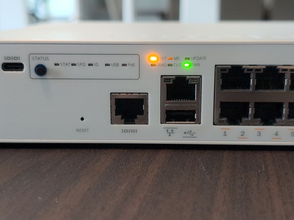

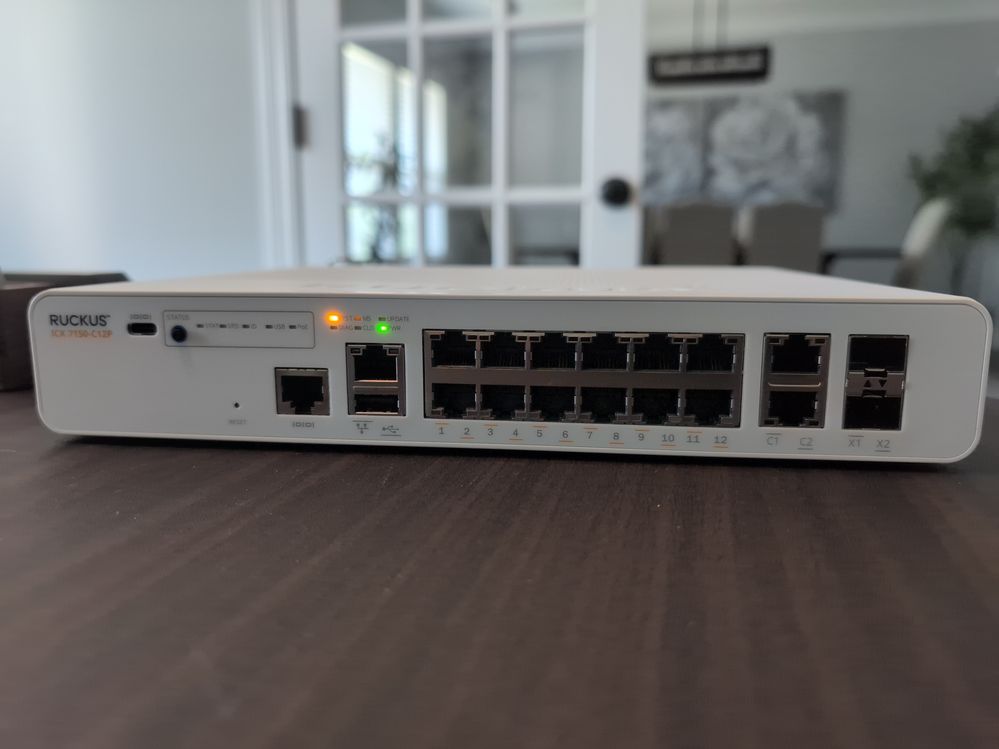

3)   On your switch while it's plugged into the outlet, do you see any lights on? (Amber or green) Please let us know which lights are on. (Please refer to the below picture and share a picture of the same, showing the light status and the FULL Switch panel cable connections to the Switch ports)
→See below:
Ruckus close-up.jpgRuckus full.jfif

Hi @BillRamos ,
From the response shared, I understand that the status lights on the Switch is Amber and the PWR light is Green which means that the Switch is stuck in the boot mode.
Please follow the below RUCKUS Lennar Knowledge base self-help article which will help you to fix the issue when the Switch is in boot mode.
https://community.ruckuswireless.com/t5/RUCKUS-Lennar-Support-Knowledge/Fixing-RUCKUS-Switch-with-an...
As you have performed reset multiple times, the only option is to perform software recovery.
Please follow the process as explained in the article and let me know if you have any queries in this regard.
