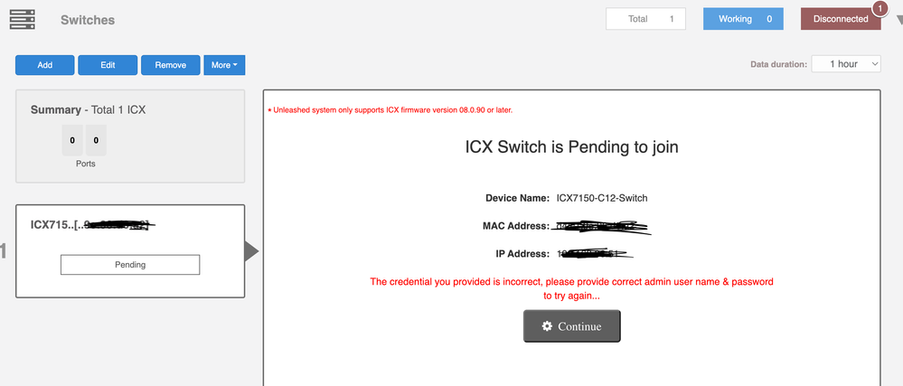

Also please share the image of the status of the switch showing in the unleashed dashboard
Thank you. See attached photo.
Re. the credentials, I was able to login to the switch IP web interface with no problem with the credentials I set through the CLI. So I'm not sure why those credentials are not working to authenticate through Unleashed.Screenshot 2023-08-08 at 10.40.46 PM.png

Hi @persepheone
Taking consideration that the unleashed dashboard/ application have their own credentials and to manage the access points and the switch has other credentials to manage the switch.

None of those combinations work 😕 What's the next best course of action? Thank you
Valued Contributor III
Hi @persepheone
Thanks for your response.
If the default credentials does not work we need to perform password recovery process.
