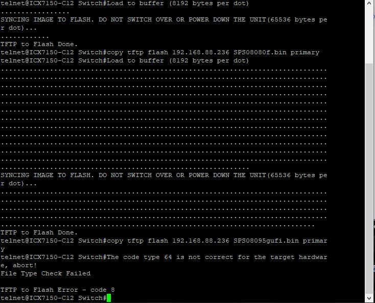

I was able to run the boot, able to do the first upgrade, however it failed the second upgrade. See image attached.
08-07-2023 03:36 PM
Hi @Nstars07
Thank you for the update.
Please make sure you have performed all the commands highlighted in the below screenshot, before you go for copy tftp flash 10.x.x.x SPS08095gufi.bin primary
