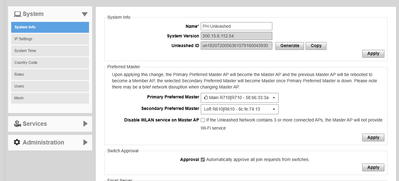

First, configure the preferred master via System->System Info. Select your preferred Access Point as the Primary Preferred Master AP.
The "Secondary Preferred Master" option is not really important, as we only give static IP to the Primary Master AP, and other APs will continue to use DHCP.

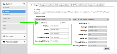

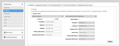

In the second step, go to System -> IP Settings and then the first tab (IP Settings) to configure static IP for the master AP. Check the values (Netmask, Gateway, DNS servers), then change the setting from DHCP to Static and manually type a new value in the "IP Address" field.

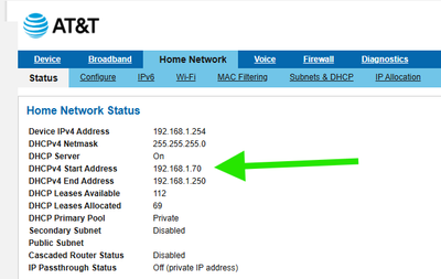

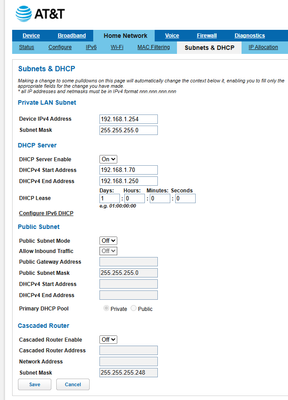

What exact IP to dedicate as static IP is your decision, based on what router you have and how its DHCP range is configured. I cannot provide instructions on how to do it with your router, but you might be able to get some help from your ISP (Internet Service Provider). For example, the range is 192.168.1.70 to 192.168.1.250, so I have chosen a free address just outside this range. Again check that this address is not assigned to any other device, otherwise, it would lead to an IP conflict.
