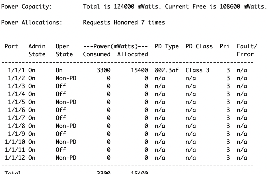

I have a Lennar Home with Ruckus. After the power outage my R510 AP has gone dark - no lights and the connection to the switch does not show any light. Other ethernet lights all blinking. I have tried to read the techincal solutions here but way above my expertise. Also, I have only Apple Mac computers so most instruntions are for PCs.

Hello @Beanwinker ,
From the response you shared, I see that you were trying to connect to the terminal through ssh.
I would request you to please access the terminal through the Telnet option.
Once you open the terminal, please follow the below commands as mentioned in the below screenshot.
nc <IPAddress of the device> 23
Example: nc 192.168.254.62 23

I did find a way to install Telnet on my Mac and followed the commands you sent. Indeed the 1 through 12 were off. I enabled them. See the attached image. Power has been restored to the AP! Thank you for your patience and support. Took awhile to get Telnet installed on an older Intel iMac instead of my Apple Silicon MacBook Pro. Really appreciate your patience.
I wanted to attach a screen shot of the Switch configuration but I cannot upload photos on to your site any more. Let me know how to share the screen shot - seemed to have worked before.
Sid

Hi Pinky - here is the screen shot:

Hello @Beanwinker ,
We are glad to know that you were able to enable the PoE on the Switch and the Access points are turned on now.
