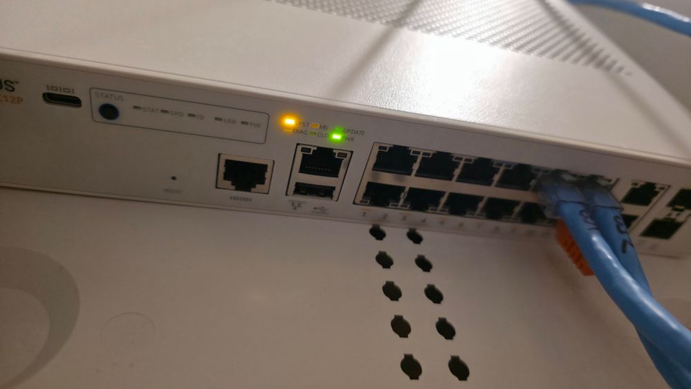

Powers on. Reset didn't fix. Hotspots are not powered on. ICX7150-C12P
Br0Br0
Need repair replacement steps

Hi @Br0Br0
Thank you for the update.
Based on the image you shared, the amber (orange) LED on the RUCKUS ICX-7150-C12P switch indicates that the device is currently stuck in boot mode.
Please refer to the RUCKUS Lennar Knowledge Base self-help article below for detailed steps on troubleshooting this issue:
https://community.ruckuswireless.com/t5/RUCKUS-Lennar-Support-Knowledge/Fixing-RUCKUS-Switch-with-an...
Kindly follow the troubleshooting steps outlined in the article, and let me know if you encounter any issues or need assistance at any stage during the process.

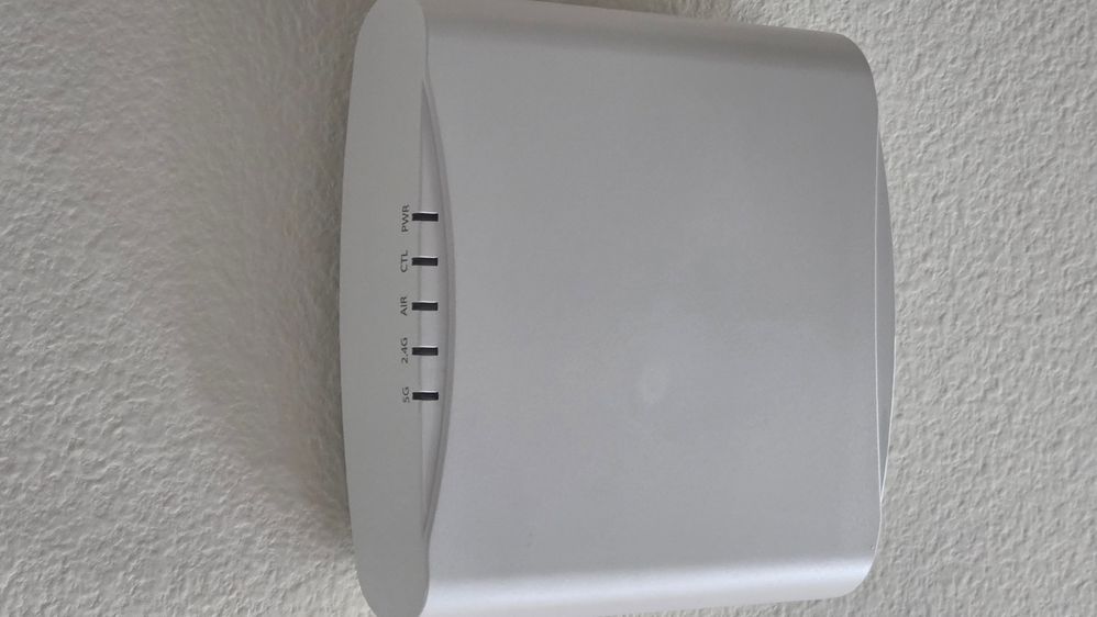

3. How many access points are currently connected to the switch? Please describe the status of the lights on the access points. Similarly, include a photo showing the access points' light status.
Br0Br0
Yes, I recall a power outage or internet outage. Not sure if hardware failure cause the outage. Happened a couple years ago and haven't tried getting it repaired until now.
Hi @Br0Br0
