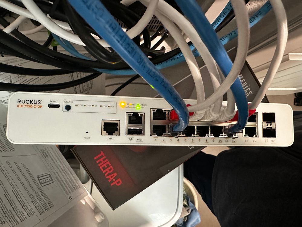

On your switch while it's plugged into the outlet, do you see any lights on? (Amber or green) Please let us know which lights are on. (Please refer to the below picture and share a picture of the same, showing the light status and the FULL Switch panel cable connections to the Switch ports)

11-10-2023 03:55 PM
I did the powering off while holding the reset button

Hi @AlvinR
As I can see from the picture you shared, there are lights on PWR and SYST, if there is an amber/orange light on the "SYST" and a green light on the "PWR" on the Switch (as it is in the below picture). Meaning the Switch is stuck in the boot mode.
Basically, due to the power outage/ power spike, the switch went to a state that we call ‘boot mode’ that is not able to boot up properly. And this is the reason your RUCKUS ICX-7150-C12P Switch is unable to transmit power (PoE- Power over Ethernet) to the Access Points or on its ports.
