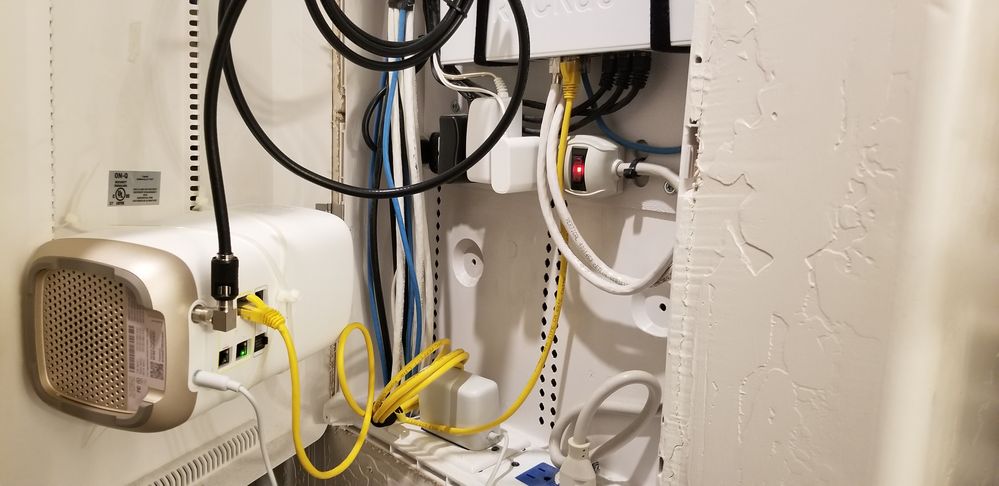

We had power outage, now the Rukus modem will not start or reboot. I unplugged for 30 seconds and plugged it in, the lights all flashed green then immediately turned off again. Do I need to replace the modem? Trying to reset via the pin hole does nothing because it is not powered on

Based on the troubleshooting done, your ICX-7150-C12P Switch is not powering up, and when plugged in, it flashes an amber light and then goes dark. And you confirm that the Switch is plugged into a well-known outlet/power source. However, the failure persists. This Switch unit Should be RMA (Return Merchandise Authorization) in simple words replacing it.

Hi @Brian1
Based on the information provided, it appears that you are encountering issues with the RUCKUS setup after a power outage.

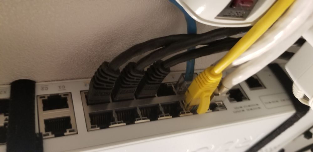

1. When your switch is connected to the outlet, do you observe any illuminated lights (amber or green)? Kindly describe which lights are visible. Additionally, please provide a photo showing the status of the lights and the full switch panel with cable connections to the switch ports.

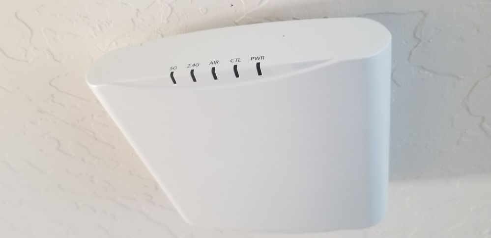

2. How many access points are currently connected to the switch? Please describe the status of the lights on the access points. Similarly, include a photo showing the access points' light status.

We have 2 R510 access points . All lights on the router/modem briefly flash yellow then turn off immediately when trying to reboot by unplugging and then plugging the power cord back in. The access point lights are off as well.

1. Take out your Switch from the closet. Plug your ICX-7150-C12P Switch into a functioning power outlet.
Please confirm once uploaded and should you have any queries or require further assistance, please do not hesitate to reach out. We are here to help.
