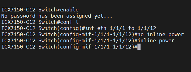

04-11-2024 12:01 PM
Imran,
I've run the commands above. The "no inline power" and "inline power" commands ran very quickly, and I did not receive any errors. My devices are still without power however. There are no lights on the APs and the Ring doorbell shows as offline.
04-11-2024 12:13 PM
Hi @DerekE82
The output must look like the below example.
Please check once again and let me know if you have any queries in this regard.
04-11-2024 12:26 PM
Let me know if I'm doing something wrong here
