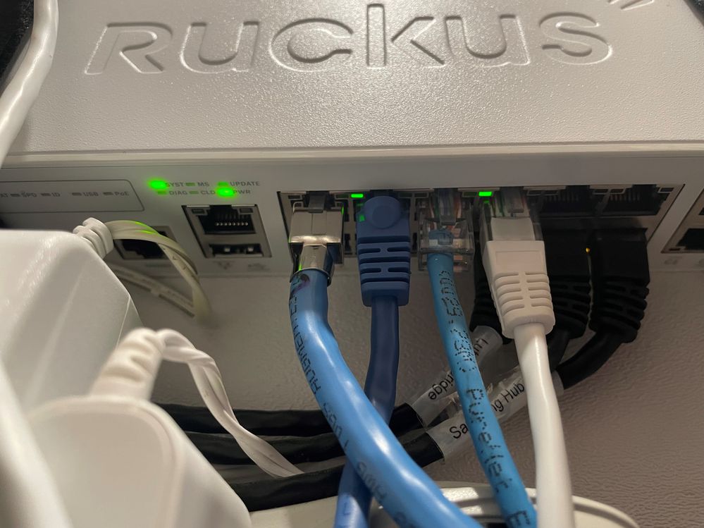

2. On your switch while it's plugged into the outlet, do you see any lights on? (Amber or green) Please let us know which lights are on. (Please refer to the below picture and share a picture of the same, showing the light status and the FULL Switch panel cable connections to the Switch ports)

2. Picture included. Green lights for SYST and PWR as well as all connections that do not require POE. The connections that use POE have no lights.

As per the Switch light status, it is in a normal state. However, as APs are not getting power, we may have to check the PoE port and some other details of the Switch by getting CLI access to the Switch. please follow the below steps to check the same.

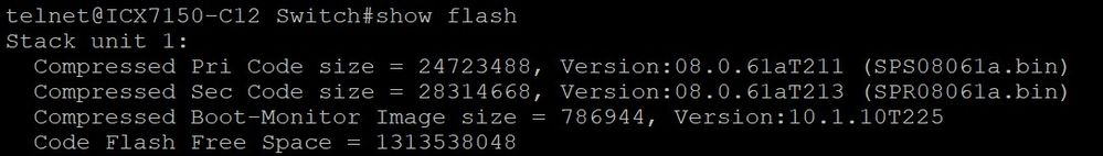

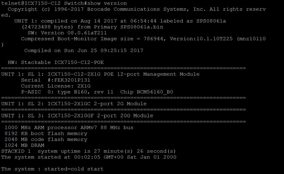

show version
show flash

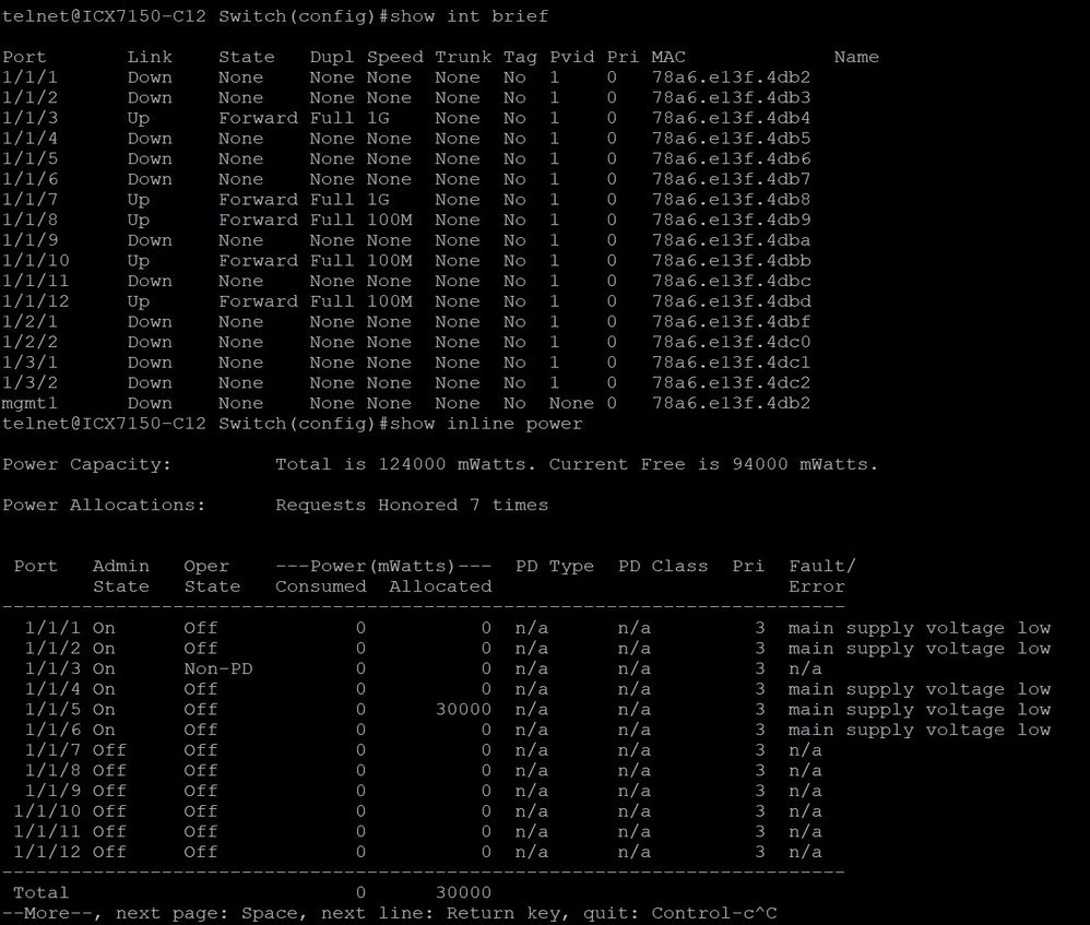

show inline power
show interface brief
Thank you again.
08-25-2023 10:53 AM
Screenshots attached. Looks like a "Main Supply Voltage Low" problem.
