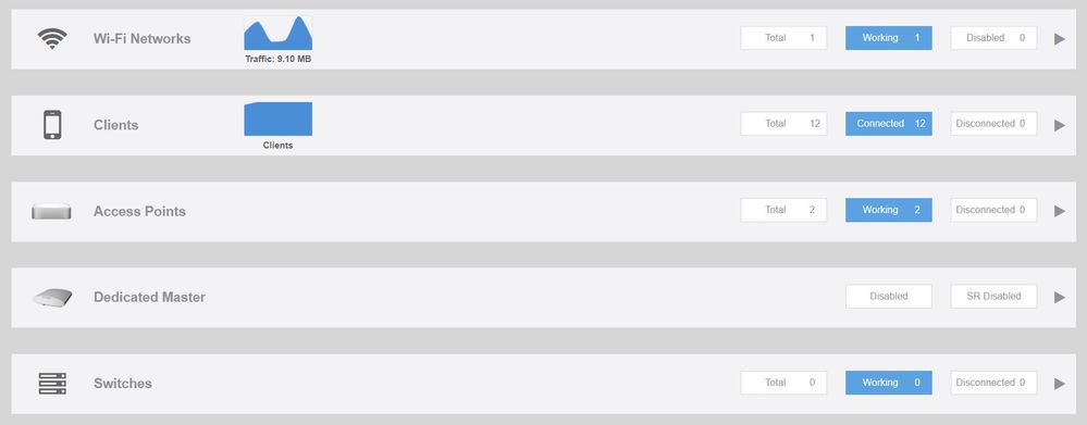

I also noticed the Unleashed admin portal shows 0 switches. I am not sure if this was the same before the storm.

Screenshot from admin portal:

Hi @Iceman
Thank you for your recent communication and the provided information.
From the screenshot you shared, the RUCKUS Switch is not added into the Unleashed system. Since the Switch has not been integrated into the Unleashed system, please follow the outlined procedure below to manually add
**Switch Configuration:**
1. Ensure that management approval is enabled on the Switch.
**Access Points (Unleashed) Configuration:** (Refer to the below steps and screenshots)
1. Access the Unleashed dashboard.
2. Navigate to the "Add" function on the dashboard.
3. Enter the IP address and password for the ICX switch (ICX-7150-C12P). This IP address is the same one used to access the Switch CLI.
4. Use the same username and password for Switch authentication as you would for accessing the Switch via web or CLI (e.g., Putty).
5. Data synchronization may take several minutes. Once completed, the status should indicate "connected" on the dashboard.
Please review the dashboard post-synchronization to ensure the Switch has been successfully integrated.
Should you have any questions or require further assistance, feel free to reach out.
Thank you once again for your attention to this matter.

Pinky, adjusting my Windows firewall settings resolved that error and I was able to complete the upgrade. I fixed a missing cord and that resolved the ethernet jacks. Everything is working now but the Unleashed portal still shows 0 switches. Please confirm if this is expected.
