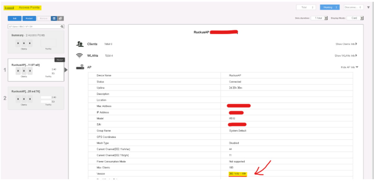

Please check the current version of your Unleashed Access Points and share a screenshot of the same.
Please refer to the below screenshot for more information on how to know your Unleashed Access Points version details.
Please help us with the above requested information and let us know if you have any queries in this regard.
