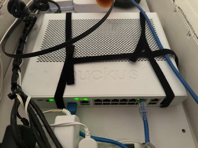

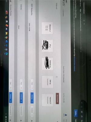

I have tried Factory reset to AP through web. it shows that its completed but i am not able to see system name in available network. I am able to login as admin but it shows disconnected for internet ( Refer image) . Refer the image of port setup.

Hi @dha009
As I see from the picture you shared, seems like the ethernet cable which is coming from the ISP’s (Internet Service Provider’s) Router or Modem/Router combo is plugged into the wrong port on the Switch panel. It must be plugged into any 1 in-12 ports as shown in the below screenshot. Please unplug the ethernet cable and it into the correct port then reboot (unplug and plug from the power outlet). Try to connect to the Internet via Access Points. Also connect ALL the unplugged Access Points back to any of 12 ports.
