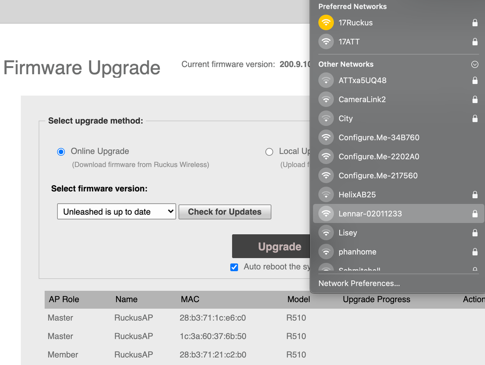

Hi, I bought a new Lennar house recently, and having a maddening time trying to get the middle R510 Ruckus WAP to work correctly. There are 3 in the house, the bottom floor, middle floor, and top floor.
I was able to set up for the top and bottom, but the middle never joined the Unleashed network automatically, and even after hard resetting it via the button, it would still broadcast the Lennar-xx network. Until finally today I got around to hooking up an ethernet cable from the middle WAP to a laptop, factory reset it, got it on the latest firmware, etc., I got it to Configure.Me.
But I want it to join the rest of the WAPs. Can you help me run diagnostics to see what's going on? See the image below, it shows 2 Masters. This is before I factory reset it.

@syamantak_omer Thank you. Can you provide more details? I'm not too technical.
2. I believe it has an IP? I set my ethernet IPV4 to 192.168.0.22 per instructions, and then if I go to 192.168.0.1, I see the Ruckus web interface on the problematic AP.
3. How do I SSH into it with Putty?
4. What is CLI? I assume that is Command Prompt Line? Do I use Putty for CLI or Windows Command Prompt?
Hi John,
If you are able to access AP with it's default IP address 192.168.0.1, this means AP is not getting IP from the switch and without a valid IP from the same network as other APs, it cannot talk to other APs.
To test if SW is providing a DHCP IP, try to remove eth cable from the AP (problematic AP) and plug it to your laptop, check if your laptop gets an IP. It should get IP on the same subnet as other APs.
If not, then it must be switch or DHCP configuration issue. If you are not too technical, I suggest you to open a case with RUCKU support as it may be difficult to troubleshoot switch configuration related issues.
