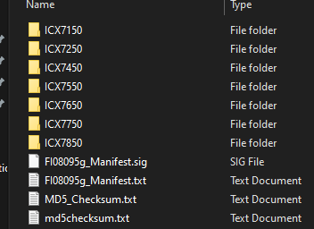

Your Upgrade folder should contain these 3 files shown in the below screenshot: (Refer the guide link for more information)

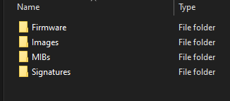

08-10-2023 04:08 PM
Hello Imran
i downloaded zip files to upgrade but the contents look different than the screenshot you posted.
and there is no upgrade folder inside ICX7150
08-10-2023 04:24 PM
Hi @ruckus_houston
Please note, we have to create a new folder (We mentioned a folder with the name ‘Upgrade’ as an example) and we have to add those 3 files to that folder from the 08080f and 08095g zip files we download.
Please refer to the 2nd option link in which we have mentioned all the steps clearly. (sharing the link once again below)
Below are the folder shown in the screenshots where you can get those 3 files:
