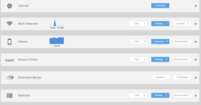

I logged into the admin console via browser [found a pwd that works]; please see screenshot below. Will this console help me get my connection issue sorted? I noticed that "working" switch is 0. [I am connected via WiFi]
