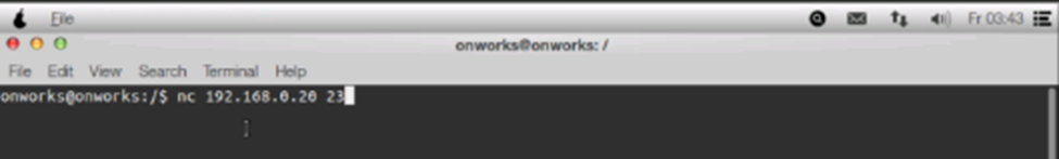

I understand that you are using Mac laptop and you can access the terminal in the Mac laptop to login to Switch.
Once you open the terminal, please follow the below commands as mentioned in the below screenshot.
nc <IPAddress of the device> 23
Example: nc 192.168.1.182 23
????telnet@ICX7150-12P Switch>
Once we get the above prompt, we can execute the required commands as shared in the previous post and share the screenshot or output of the commands.
