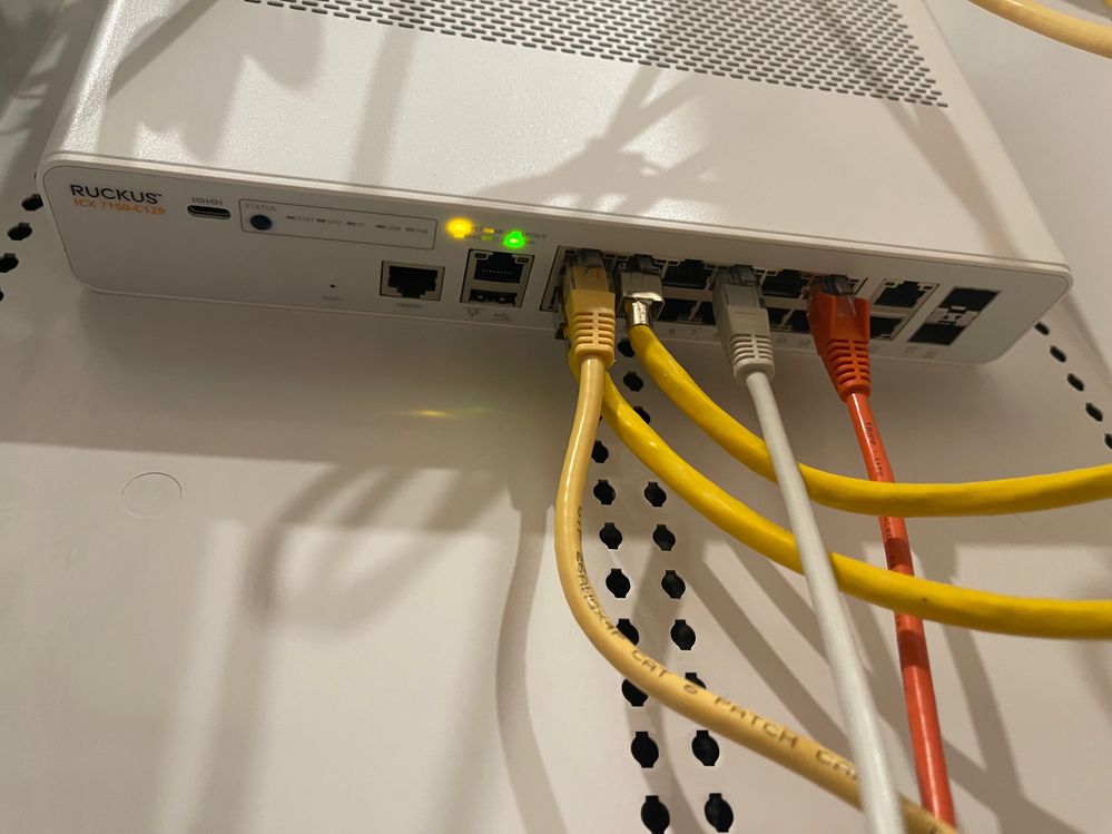

Hi, we purchased a Lennar homes 2 years ago, the network server downstairs and upstairs stop working one month ago, Lennar gave us the link to contact you for this issue. We were charged $4,000 each for network server by Lennar builder, and they stop working just after 2 years , could you please have someone come to fix them?

As we can see from the picture you shared there is an amber/orange light on the "SYST" and a green light on the "PWR" on the Switch. Meaning the Switch is stuck in the boot mode.
Basically, due to the power outage/ power spike, the switch went to a state that we call ‘boot mode’ that is not able to boot up properly.
Please follow the below steps in order to fix this issue:
First, we will try to reset the Switch as described below:
3. We must get console access to the ICX-7150-C12P Switch as mentioned in the steps from the guide below:
How to console in the ICX-7150-C12P:
Below are the Guide and Video Link to perform the Software recovery process:
Please let us know once you finish this process. So that we could assist you in upgrading your Switch to the latest stable version to avoid these issues in the future.
Thank you again.
Lennar Home Community.
