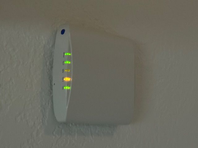

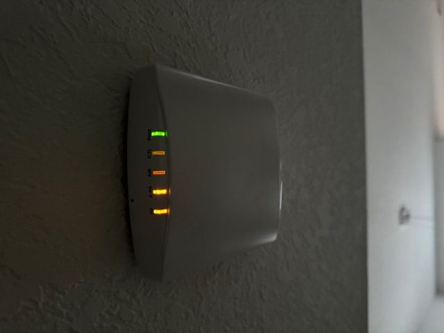

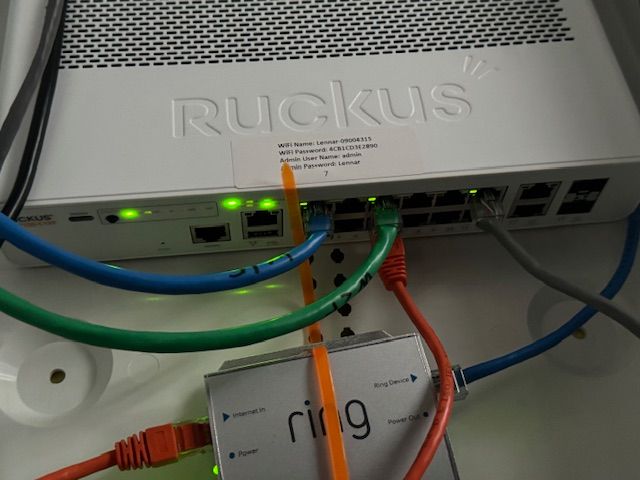

2. Could you please let me know the light status on the Access Points? Any of these lights are on (Please refer to the below picture and share a picture of the same)

hello there and thanks for the response, please find attached all 3 pictures of the switch and 2 access points
as stated when it works it gives great speed. but the dropping connection is killing me as i work from home and get disconnected all the time.

Hi @Gabinhox
As per the pictures you shared, the light status of the devices and the connections seems in a normal state.

hello,
I im not able to see the switch address when i see the scan. i can see both access points but every time i type those address into the bar it takes me to the unleashed site.
if i log in into my isp router i can see an ip address assign to port one that has the name ICX7150-C12-Router. but when i try the ip that says there it doesn't do anything. on putty i am able to log in to both access points but not the switch it says connection time out.
could that be the problem ? what can i do ?
