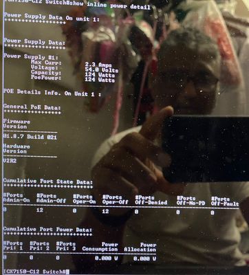

My Rukus is not broadcasting any internet and there is no power in my AP's after a power outage. I tried to reboot and also tried the reset with connection to the console but no luck. I cannot upload pictures. Can you please help.

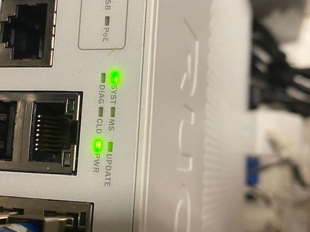

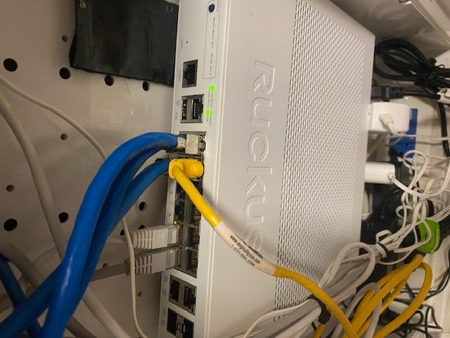

i have solid green on SYST and PWR. The AP's are connected on POE 1 to 3 and the ethernet for the internet is connected to POE 4.

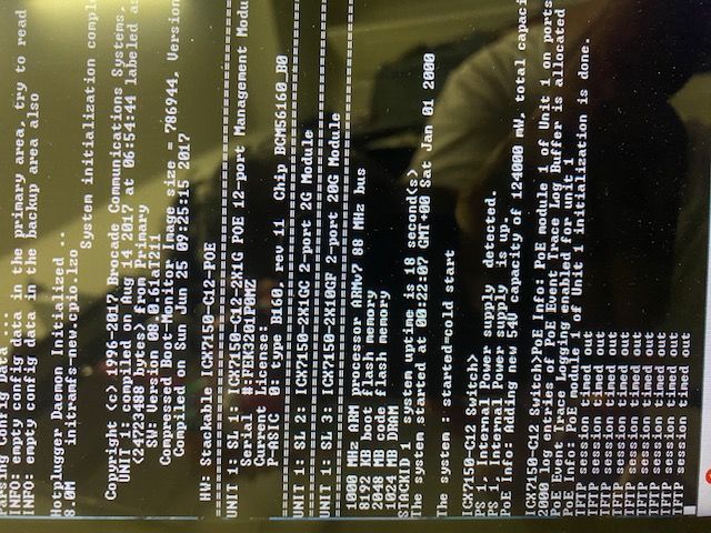

"TFTP session timed out" message appears because the switch is looking for a TFTP server to load the configuration file from the TFTP server but there is no response from the TFTP server so for that reason creates a time out.
You can ignore this message if you are not going to download a configuration file from the TFTP server.
1. Here TFTP is not recommended. Sometimes we may need TFTP to Upgrade the switch via TFTP. And for now, we could disable it to prevent those continuous messages on CLI.

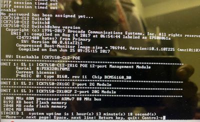

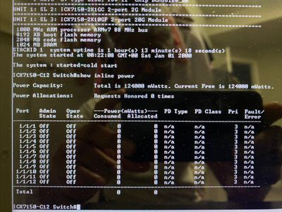

2. As you have console access, please perform the below commands, and send us the output for the same.
show version
show inline power
show inline power detail

06-05-2023 04:45 PM
Please
see attached..

Can you please confirm if the modem ethernet connection is in the correct port.. I currently have it connected to Port 4 of the 12 ports.
