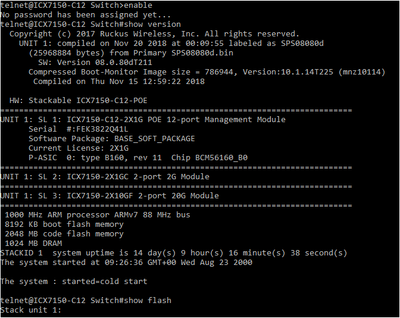

All though I am not having any issues, I thought I'd post my switch version. It appears I wan way behind in updates. Please advise if I should update or leave well enough alone.

As per the case description, I could understand that you need assistance in Upgrading your Switch to a new stable version.
As I can see from the Screenshot you shared, your Switch is currently on an old version and that is 8080d as marked in the below screenshot (non-UFI). To avoid any issues I would recommend you Upgrade your Switch to the latest stable UFI version.
The recommended stable versions are 8095g (08.0.95g) or 8095j (08.0.95j)
The Upgrade path would be 8080d>>8080f>>8095g OR 8095j
Below are the options or methods to perform the Upgrade on the switch: You could choose any one of these.
