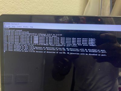

As I can see from the information you shared, the PoE is in the disabled state on all the ports of the Switch (Please refer to the below screenshot). By which the Access Points are unable to get the power.
To enable the PoE on the Switch, please perform the below commands from the CLI:
Switch>enable
Switch#configure terminal
Switch(config-mif-1/1/1-1/1/12)#inline power
Also attaching a Screenshot below as a reference:
Once you perform the above process all ports should be On, and APs should get the power.
