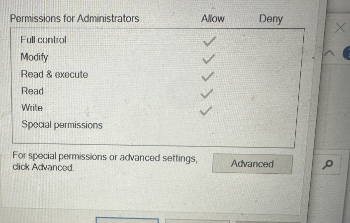

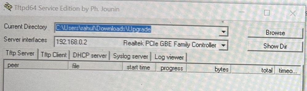

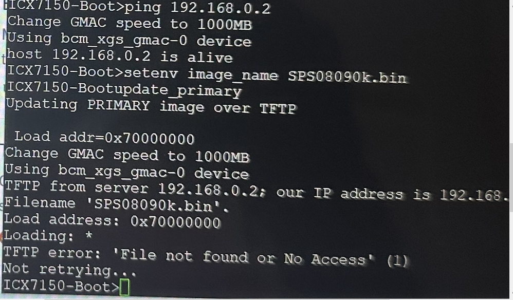

Hi Pinky, I was able to get the ping status alive now. However, when I perform the recovery I am getting file not found or no permission issue, but I did check that the path is correct in tftp, file has all the permission for all users in the laptop including system user. Could you please advise next step from here? Below are the imagesCapture 1.PNGCapture2.PNGCapture3.PNGCapture4.PNG
