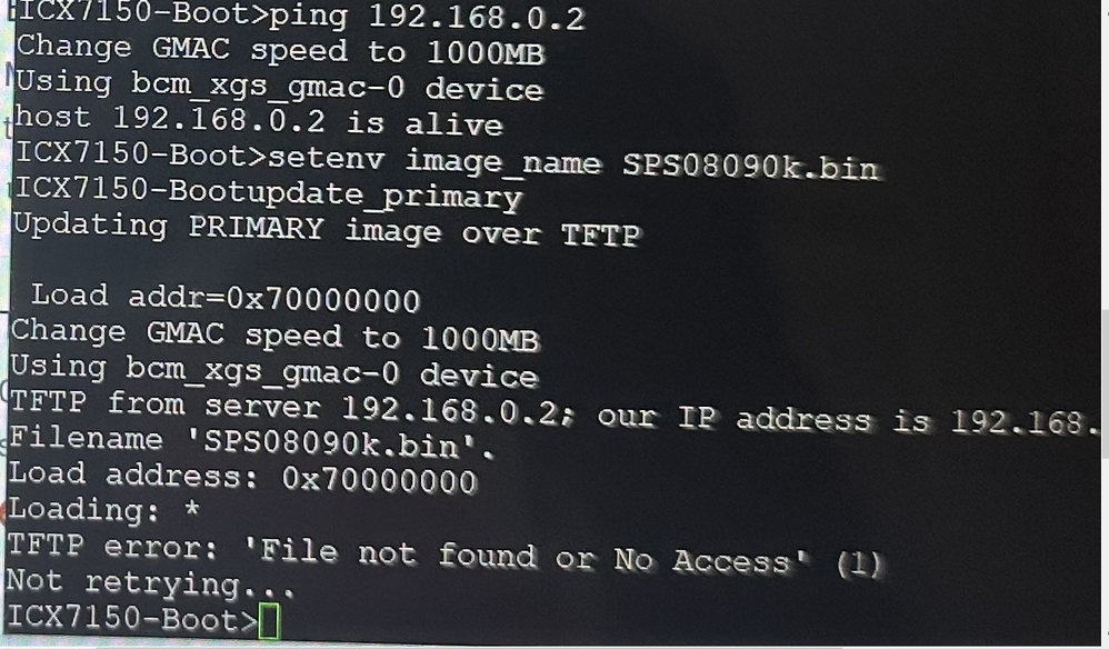

Recently there was multiple power outages back to back since then my ruckus switch isn’t working, it has power but sys label is stuck with amber light. None of my access points are powering up either since then. As I found here in the forum, I tried resetting many times by using reset button and simultaneously plugging the power, but it didn’t work. Now I learned it might failed to reboot and corrupted and I need to reinstall image or something of that nature. But I am unclear on how to do that by consoling from my laptop into switch? Or if the problem doesn’t require reinstalling image but something else? Any help here is greatly appreciated as I am stuck and switch isn’t working from last few weeks.

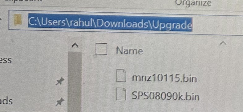

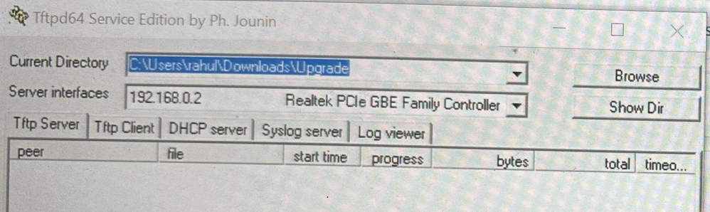

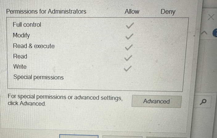

Hi Imran, I was able to get pass the issue and now the ping status is alive. However, when I perform the recovery I am getting file not found or no permission issue, but I did check that the path is correct in tftp, file has all the permission for all users in the laptop including system user. Could you please advise next step from here? Below are the images

Hi, yes I did and now I am facing a different issue with file access from tftp, please refer to my previous reply dated (‎12-09-2025 07:07 PM) where I posted screenshots and detailed explanation of the issue.
