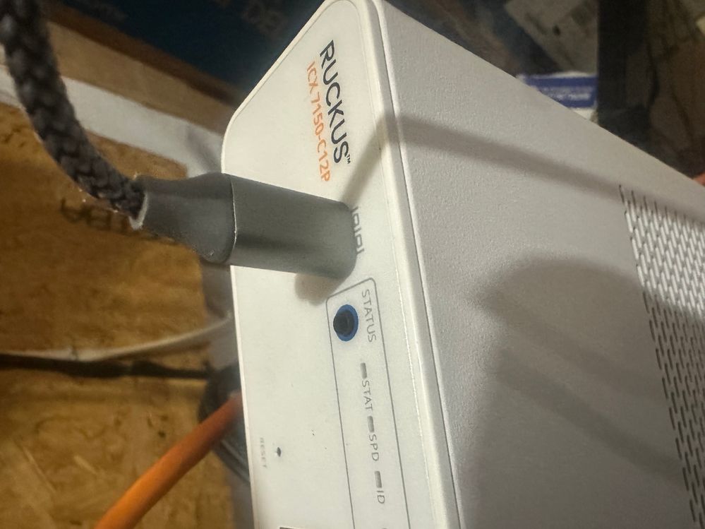

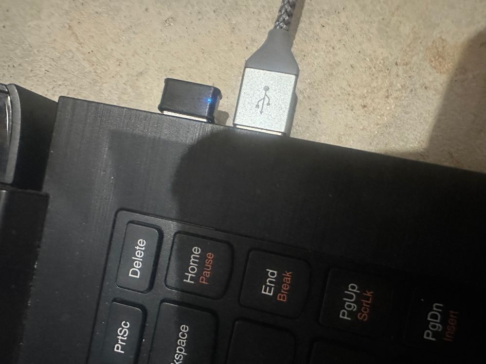

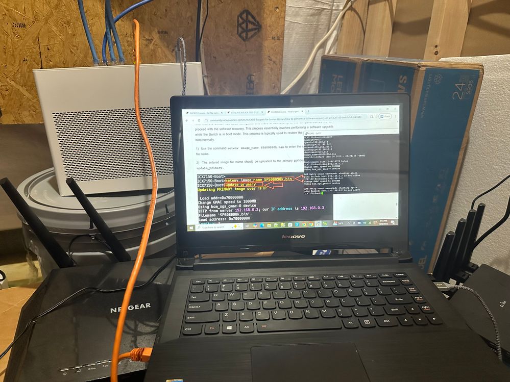

Could you please share a picture showing the Software Recovery cable connections between the Switch and the laptop?
12-08-2025 05:34 AM
Hi Imran, as I mentioned earlier I am using Type C to USB connector between switch and my laptop.
12-08-2025 05:42 AM - edited 12-08-2025 05:43 AM
Hi @jsulloa
From the picture you shared, I noticed that only the USB Type-C cable is connected as shown in the Software Recovery article. Please note that both connections are required for the recovery process:
One Ethernet cable (RJ45 to RJ45)
One USB-to-Type-C cable
(Refer to the screenshot below.)
Kindly connect both cables simultaneously and perform the Software Recovery process again.
Please let me know if you have any questions or need assistance at any step.

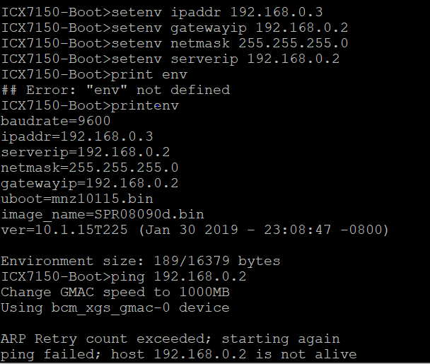

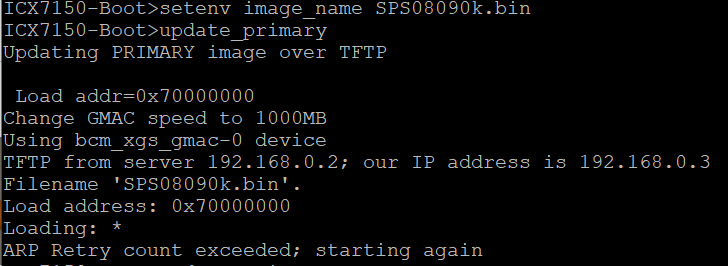

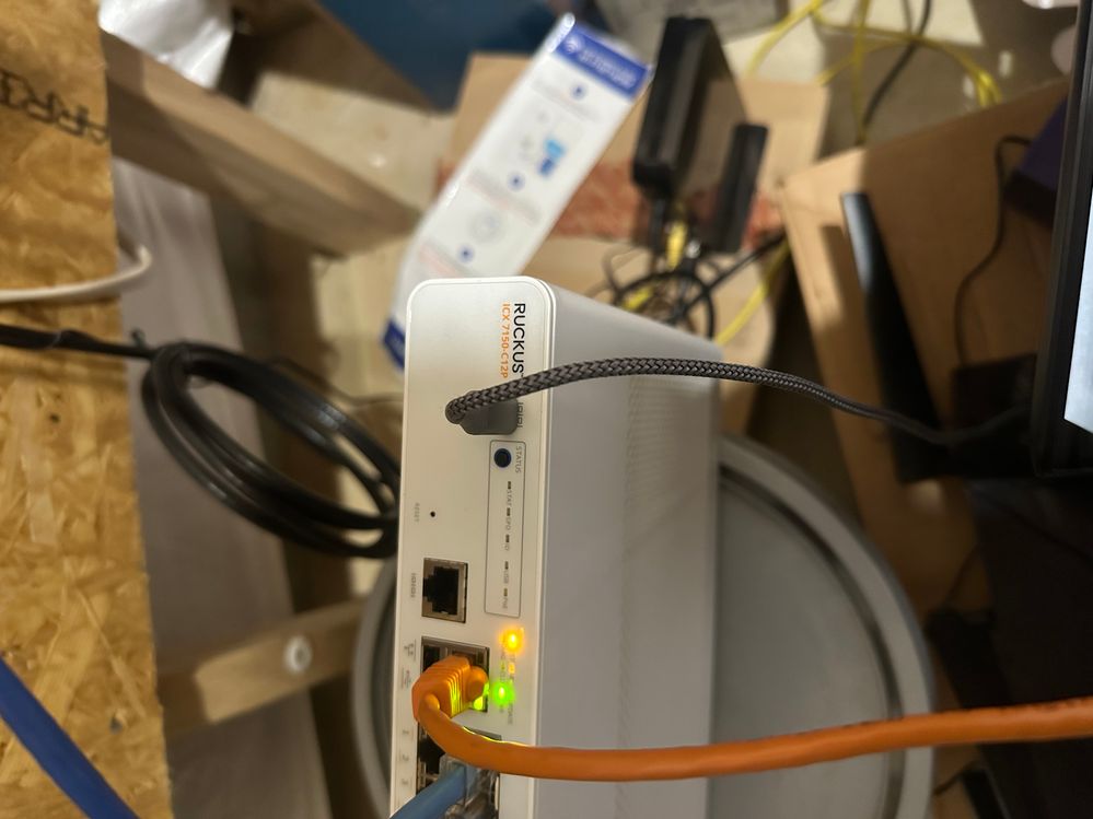

Hi Imran,
This time I tried with both the connections, please find the images below, still ping status is not alive. I did try by turning off windows firewall as well. I also tried the manual update steps in https://community.ruckuswireless.com/t5/RUCKUS-Lennar-Support-Knowledge/Fixing-host-192-168-0-x-is-n... but still did not work. Please let me know what to do now?
12-09-2025 03:40 AM

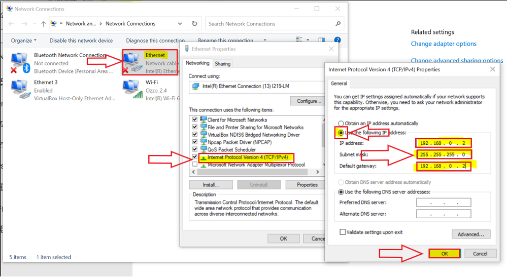

You need to configure the IP Address first on the Computer Adapter. Below is the process.
Configuring the Computer’s IP address: Let's proceed with configuring a static IP address on your computer to establish connectivity with the switch. Since the computer is connected to the switch's management port via an Ethernet cable, the IP address must be set within the same subnet as the switch to enable proper communication.
IP address: 192.168.0.2
Subnet Mask: 255.255.255.0
Default gateway: 192.168.0.2
Once done please retry the process.
Please let me know how it goes.
