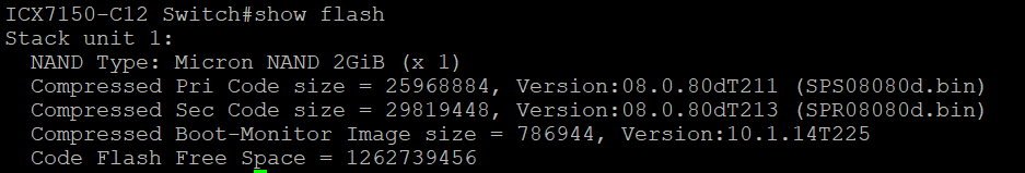

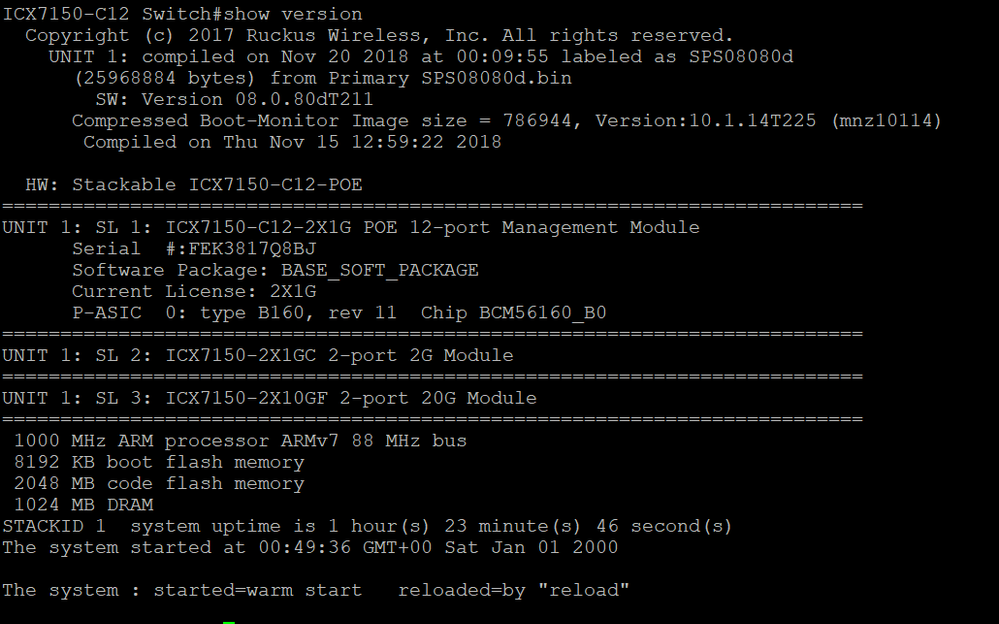

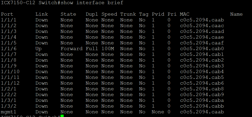

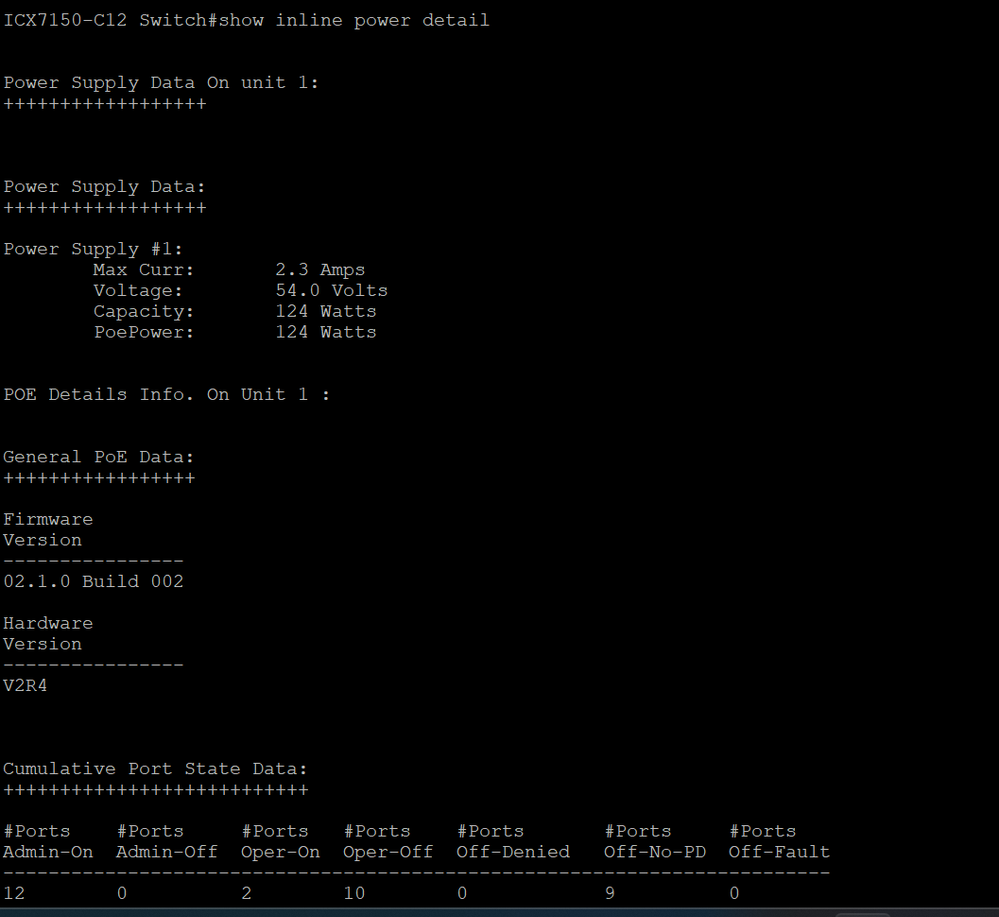

2. As you’re able to access PuTTY, please help me with the outputs of below commands.
show version
show flash
show inline power
show inline power detail
show interface brief

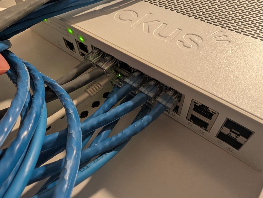

3. When your switch is connected to the outlet, do you observe any illuminated lights (amber or green)? Kindly describe which lights are visible. Additionally, please provide a photo showing the status of the lights and the full switch panel with cable connections to the switch ports.

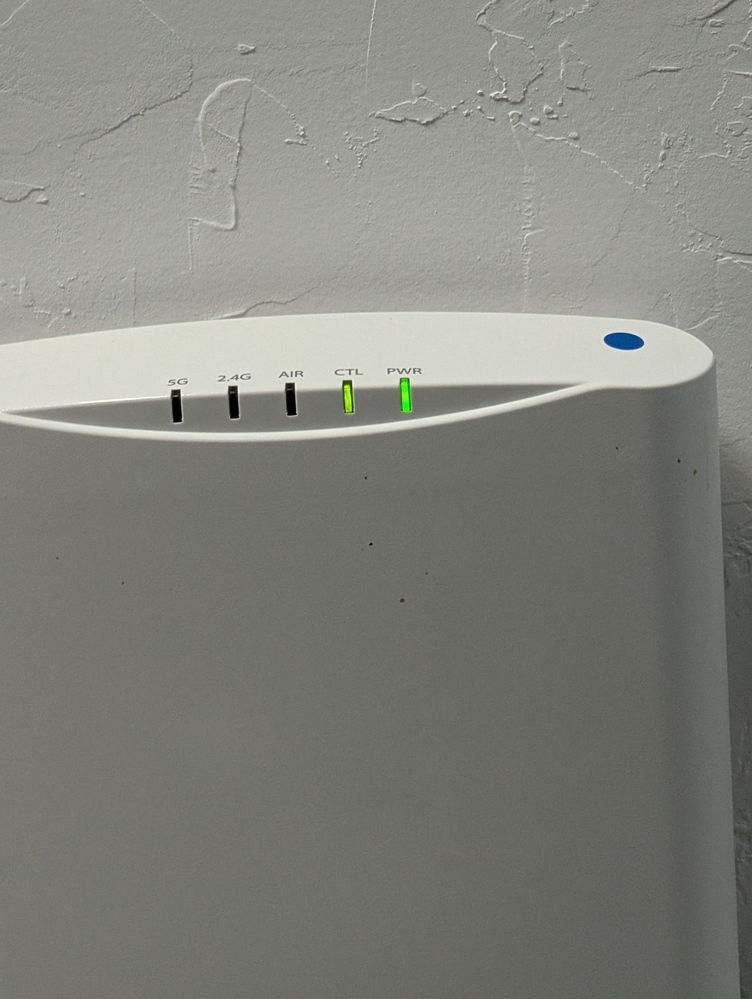

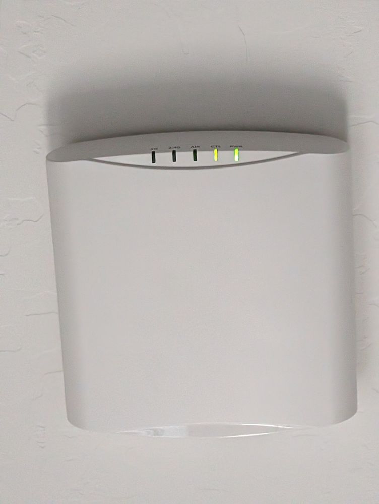

4. How many access points are currently connected to the switch? Please describe the status of the lights on the access points. Similarly, include a photo showing the access points' light status.

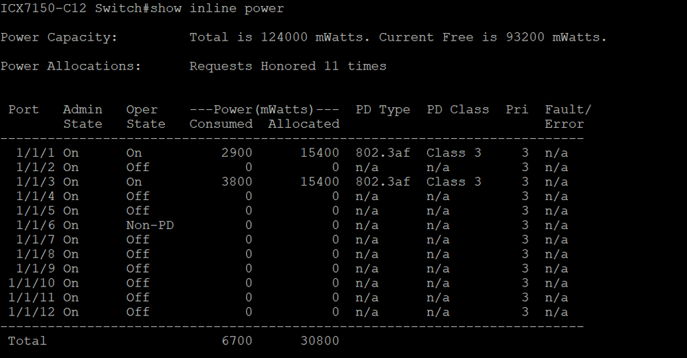

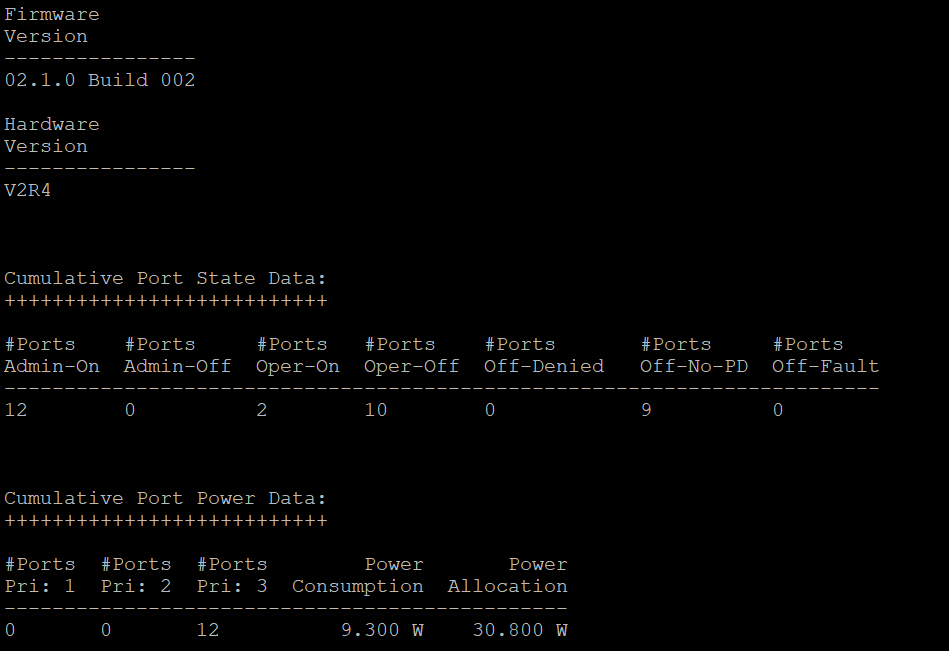

11-10-2025 10:59 AM
1. I am not sure if there was a power outage or not. Seemingly no other electronic devices that were connected had any issues besides the wifi cutting out.
2. Screenshots:
3. I have a green next to the status button, and green light system and green light power. A couple ether net ports are green lit too.
4. There are two APs ctrl is green and power is flashing green on both.

The command outputs, device light status, and cable connections on your RUCKUS ICX-7150-C12P Switch all appear normal.
Please try the following steps:
• Unplug the ethernet cables connected to the Access Points and the ISP modem from the Switch
• Plug them into any other available ports among the 12 numbered ports on the Switch
(Refer to the screenshot below for guidance)
After reconnecting to any other 12 ports, please check if the internet resumes working through the RUCKUS devices.
