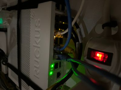

No power to access points. Resetting switch and access points are not helping.

2. On your switch while it's plugged into the outlet, do you see any lights on? (Amber or green) Please let us know which lights are on. (Please refer to the below picture and share a picture of the same, showing the light status and the FULL Switch panel cable connections to the Switch ports)
Please let me know the answers to ALL the above queries or let me know if you have any queries in this regard.

Hi @thompsonk4
As per the light status of the Switch panel, However, the Switch ports aren’t working.
Could you please try to unplug and plug back the ethernet cables from the Switch ports? Then check if the Access Points or other connected devices get power.
If the above step doesn’t work, we may have to check some Switch port configurations/details in order to get the Switch ports working.

09-29-2023 02:31 PM
I tried unplugging the switch ports and scanning for the switch, but it is not showing up as active. Unable to identify IP address
