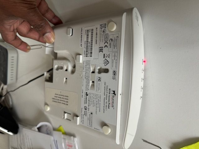

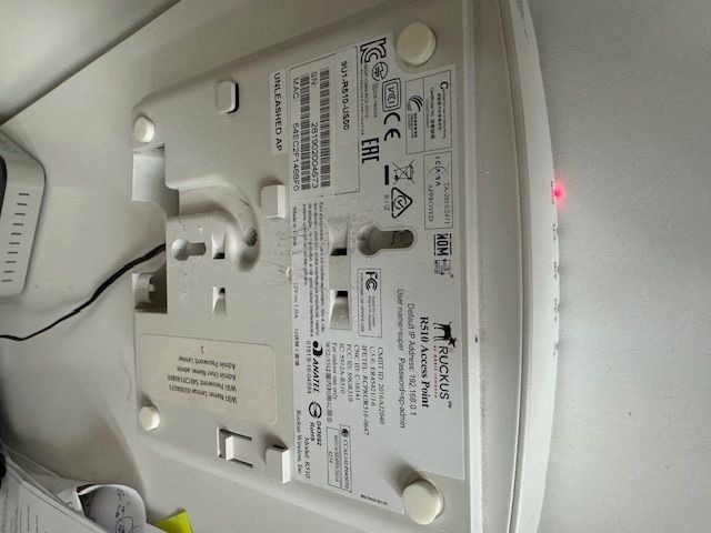

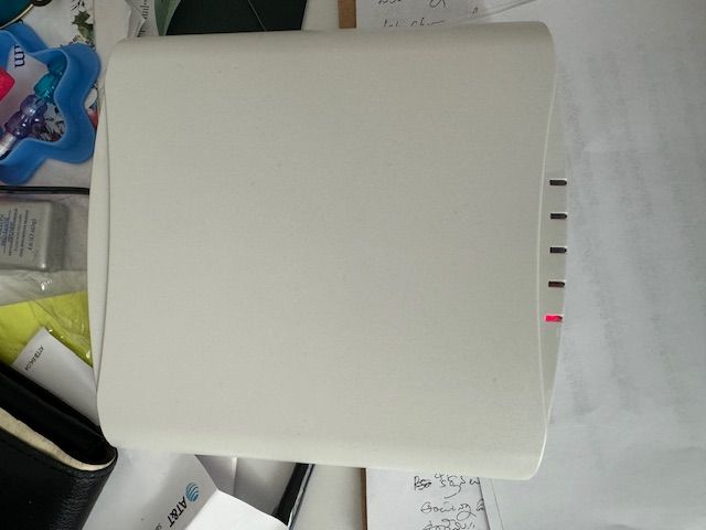

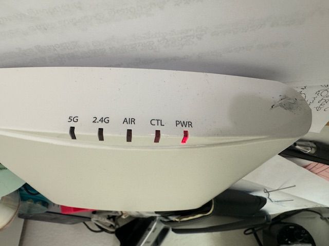

I have two R510 access points from Lennar,  one on our second floor (Master AP) is no longer working.  I can see only red light on the AP when connected to the ethernet, and no green lights. I already used many troubleshooting tasks mentioned in this support group. I tired hard reset by pressing reset button for 15 seconds. Also tired factory reset by pressing 30 seconds. Removed the other AP from switch and tried resetting, but none of the tasks worked. it always shows red.  I even tried to connect 15v power adapter directly without connecting PoE ethernet line, but no luck. I'm a software engineer and tried to fix all possible ways I found using the manuals and guides on this forum. I believe this AP is dead.

I appreciate the information you've provided. Based on the case description, it appears that one of your RUCKUS R510 Access Points (AP) is experiencing an issue, indicated by a Red PWR LED.

Could you kindly confirm whether you attempted to reset the Access Point using a paper clip, as outlined in my previous correspondence, while connected to the 12 VDC power adapter?
If affirmative, I would greatly appreciate it if you could provide a visual representation of the setup. Specifically, please share a picture illustrating the connectivity between the 12 VDC external power adapter, the power outlet, and the Access Point, along with the current status of the indicator lights.

Please find the pictures below. I connected 12v DV adapter and tried factory reset but it did not work. I appreciate your help.
