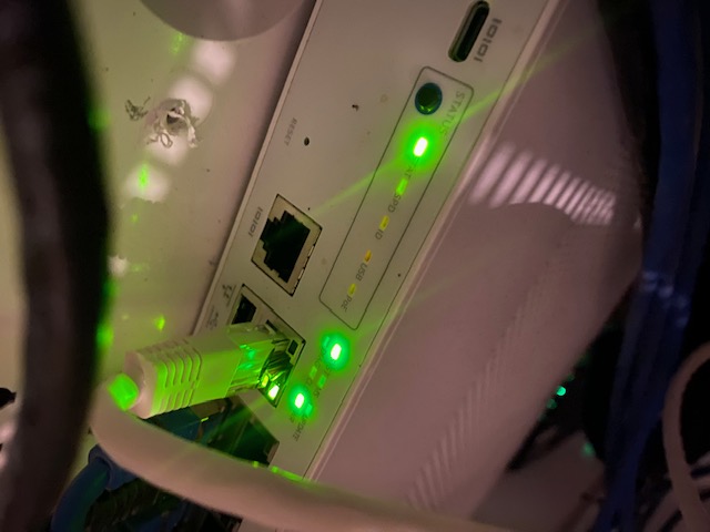

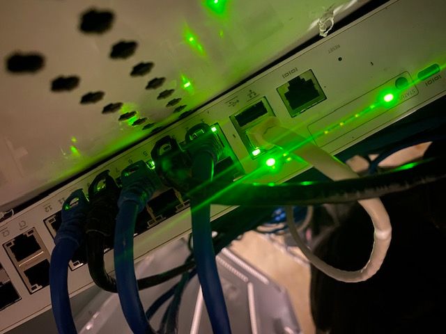

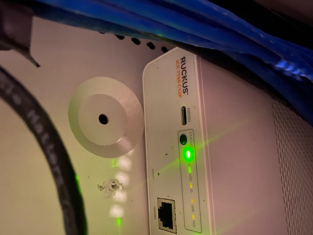

1) Verizon came in and connected our router, and the router works fine we are connected to our router. We connected the router to the switch in the garage, and nothing happens to the extenders/access points on all three floors with red lights. Then we looked at a form and suggested we do a factory reset, and so we did.

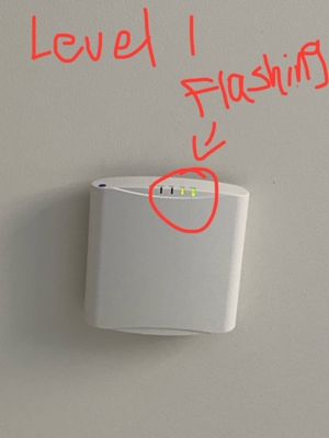

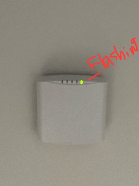

Level 1 is flashing both CTL and PWR on Green

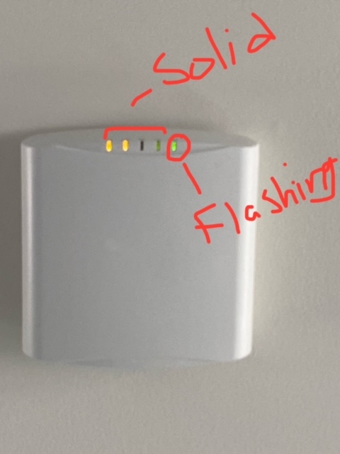

Level 2 is Solid Yellow on 2.4 and 5 with Solid green on CTL and Flashing PWR

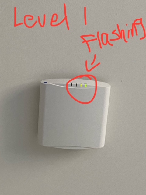

Level 3 Just a Flashing PWR
UPDATE: I moved the white Cable in the picture that was connected one of the sections with the 12 ports, now the Configure connects and goes to an website and says, website was not found. and then when I try the app too again it says no internet connection

As per the case description, I understand that your RUCKUS setup is not working, and Access Points do not have power.
As I see from the picture you shared, seems like the ethernet cable which is coming from the ISP’s (Internet Service Provider’s) Router or Modem/Router combo is plugged into the wrong port on the Switch panel. It must be plugged into any 1 in-12 ports as shown in the below screenshot. Please unplug the ethernet cable plug it into the correct port and try to connect to the Internet via Access Points. If required, please reboot (unplug and plug from the power outlet) your RUCKUS ICX-7150-C12P Switch and ISP’s router once and try again.

Hi @avaabtahi
As per the pictures you shared, the Switch and the Access Points seem in a normal state.
We may now need to factory reset the APs. Please follow the below process to factory reset your APs to configure them with a new Wi-Fi Network/SSID.
IMPORTANT NOTE: To perform a factory reset correctly on one of the access points, you must disconnect the rest of your other access points from the "ICX-7150-switch". For example, if you have 3 access points, you should go to the switch and disconnect 2 of the cables to turn off the "2 access points" and only leave 1 connected with which we are going to work the factory reset once you configure the access point and make sure all is good, go ahead and reconnect the other Access Points back.
As you have 3 Access Points in your case, remove the cables of any TWO Access Points, and perform the factory reset on the ONE connected access point. Once you complete it, connect the unplugged Access point cables back to the Switch ports and they will sync up with the configurations from the factory reset Access Point.
