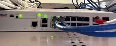

2. On your switch while it's plugged into the outlet, do you see any lights on? (Amber or green) Please let us know which lights are on. (Please refer to the below picture and share a picture of the same, showing the light status and the FULL Switch panel cable connections to the Switch ports)

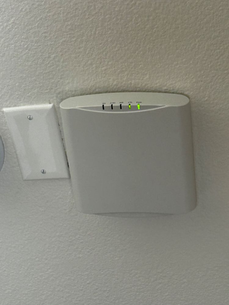

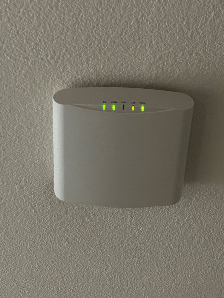

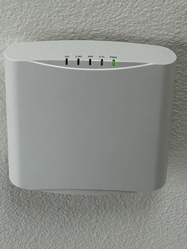

4. May I know if you have RUCKUS Access Points connected to the Switch? If yes, could you please let me know the light status on the Access Points? Any of these lights are on (Please refer to the below picture and share a picture of the same)

It came installed with the home when we bought it new.  It wasn't a power outage issue.  We disconnected it from the COX device and plugged in the new AT&T router.  But now there is no signal from the RUCKUS to connect to.
2.  All lights are on and green.

4. Yes.  3 of them.  The lights are green and flashing.  Each one has a different amount of lights on.  1st floor has all but the "AIR" light on and flashing green.  The 2nd floor has flashing green on the "PWR" and "CTL".  and the 3rd floor has flashing green on the "PWR" only.

As per the light status of the RUCKUS ICX-7150-C12P Switch and the R510 Access Points, they seem to be in a normal status.

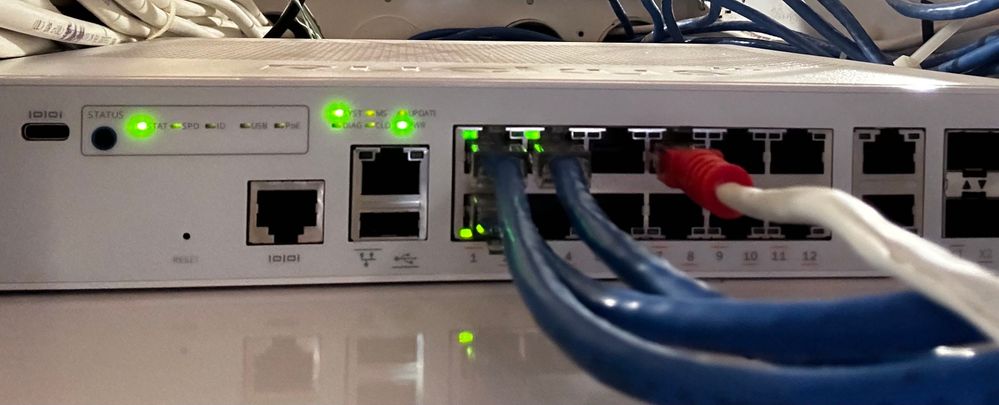

As I see from the picture you shared, seems like the ethernet cable which is coming from the ISP’s (Internet Service Provider’s) Router or Modem/Router combo is plugged into the wrong port on the Switch panel. It must be plugged into any 1 in-12 ports as shown in the below screenshot. Please unplug the ethernet cable and plug it into the correct port. Reboot (Unplug and plug from the power outlet) your ISP Router and RUCKUS ICX-7150-C12P Switch once then try to connect to the Internet via Access Points.
Hi Imran,
Thanks you for the reply and your instructions.  Unfortunately, after following the steps as directed, I still can't connect.  is the light from the ISP's cable supposed to be lit green as well?  Just like the AP's?IMG19.jpg
