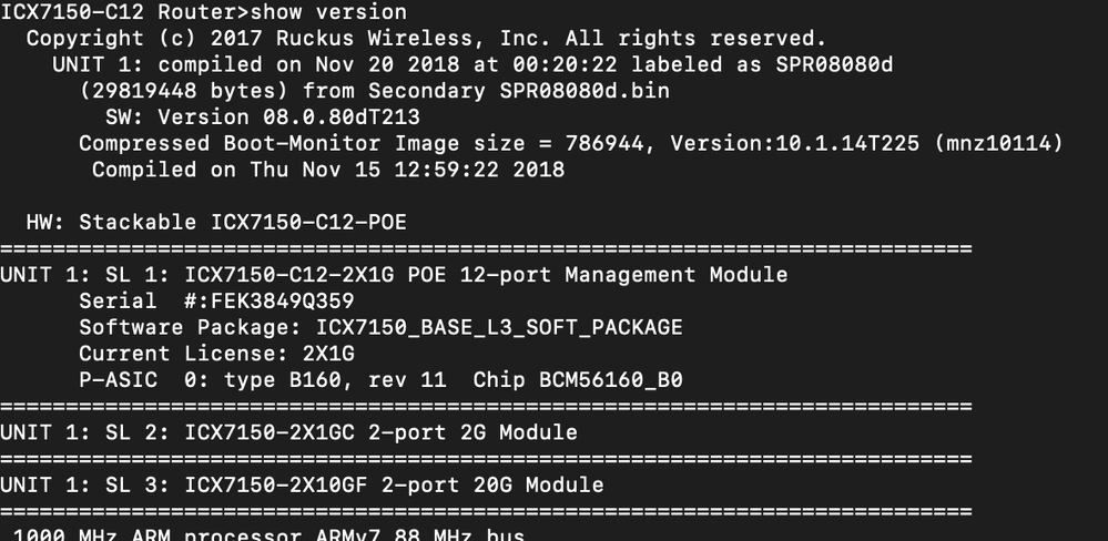

On running the command `“boot system flash primary yes”, primary partition never switched as it couldn't find the kernel image. Here are the logs I see when running the command -
NAND read: device 0 offset 0x0, size 0x2000000
5 ecc_errors after reading 18b8000:18b9800
iproc_nand_read_page returned 2
NAND read from offset 0 failed -22
0 bytes read: ERROR
## Loading kernel from FIT Image at 70000200 ...
Bad FIT kernel image format!
ERROR: can't get kernel image!
could not boot from primary, no valid image; trying to boot from secondary
device 0 offset 0x0, size 0xc0000
BOOTING image from Secondary
On running the `show version`, it is still on "Secondary SPR08080d".
how do I go about fixing the "primary" image and make a fix that doesn't need such fixes in future?

As per the case description, I understand that your RUCKUS setup is not working after a power outage.
As you mentioned and I see from the screenshot you shared, it is a Routing code issue due to a power outage.
Please refer to the below RUCKUS Lennar Knowledge Base self-help article to troubleshoot and fix this issue.
https://community.ruckuswireless.com/t5/RUCKUS-Lennar-Support-Knowledge/Fixing-RUCKUS-ICX-7150-C12P-...

So far it looks like the proposed solution works. I might have to play around for now since the issue happened intermittently.  If the issue comes back, I will reopen this thread. Thank you for your quick help.
I was earlier trying to boot from primary based on these instructions
https://community.ruckuswireless.com/t5/RUCKUS-Support-for-Lennar-Homes/How-to-solve-the-routing-cod...
As a feedback, it appears now there are 2 solutions with no clear understanding of what will eventually work.
