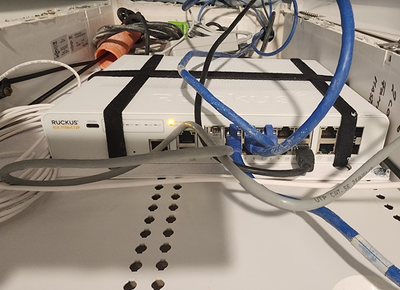

On your switch while it's plugged into the outlet, do you see any lights on? (Amber or green) Please let us know which lights are on. (Please refer to the below picture and share a picture of the same, showing the light status and the FULL Switch panel cable connections to the Switch ports)

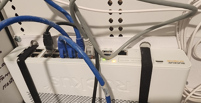

I have an amber and a green light (pics attached)

Hi @al3347
As per the light status of the RUCKUS ICX-7150-C12P Switch, it is stuck in the boot mode.
Please refer to the below Lennar RUCKUS Knowledge Base self help guide, to troubleshoot this issue.
Please refer to the above guide and let me know if you are stuck at any point in the process.
