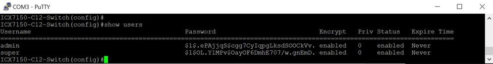

I then went back to the switch CLI, and looked at the output of the ”show users” command, and it looked sort of like this:
I don’t know why the “password” information in the command output looks so strange.  I decided to go back to Web Management and try username = super, and password = <the long string of characters shown> --- and that didn’t work either.  I then had the great idea of trying to use the Switch CLI command “username super nopassword”, just to see if I could possibly clear the password for username = super, possibly making it easier to log in to Web Management?  This was not the great idea I thought it would be --- it crashed/dumped the Switch.
The Switch eventually rebooted itself & seemed to come back on-line normally, but I noticed that the “super” username now no longer existed, so I recreated it with the username command and a simple password, but the “show users” command still shows the simple password I had entered as a long string of garbled characters (encrypted?).
I went ahead and issued the “crypto key zeroize rsa”, “crypto key generate rsa”, and “aaa authentication login default local” commands --- and after all of this, I still can’t log in to the Switch via a web browser & Web Management.
