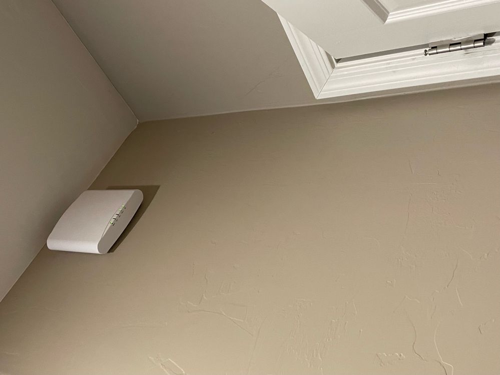

I can access my two R510 APs as an administrator (username = admin) via the web browser interface, and can see that they are both running firmware version 200.7.10.2.339. [ I had to use the Firefox browser (Chrome & Edge would not work for this) to see the Online Upgrade options for the R510 firmware, and it appears that I may be at least 30 firmware releases behind the current one, which is listed as 200.15.6.112.54 ]. I have seen comments that getting my APs onto more current firmware might solve the problem with logging-in through Unleashed with my iPhone.

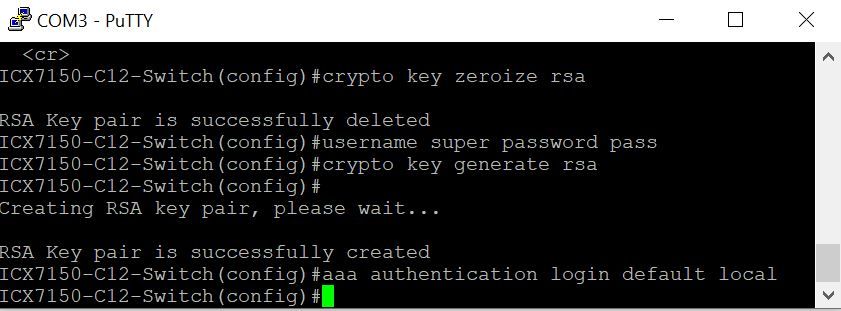

The ICX Switch is going to be difficult as well. I am unable to log-in to the Switch at all from the web browser interface --- the original installer must have thoughtfully changed the admin log-in (very helpful of them), and none of the username/password combos that I could find in the Ruckus support forums worked either. Following some other advice on the Ruckus forums, I purchased a long USB-A to USB-C cable, and downloaded PuTTY --- and I was able to gain access to the ICX Switch using this method. This showed me that the Switch firmware was version 08.0.70bT211 --- which, like the APs, appears to be far from current. But I have had worse luck finding specific information about how to deal with the Switch on the Ruckus forums.

1. Regarding the issue encountered with the message "Key already exists. Please zeroize it," kindly execute the following command and proceed with repeating the reset steps:
Command:
crypto key zeroize rsa
2. Affirmative, the factory reset process necessitates starting anew by establishing a fresh WLAN SSID. Consequently, all devices will require reconnection to the new Wi-Fi network.

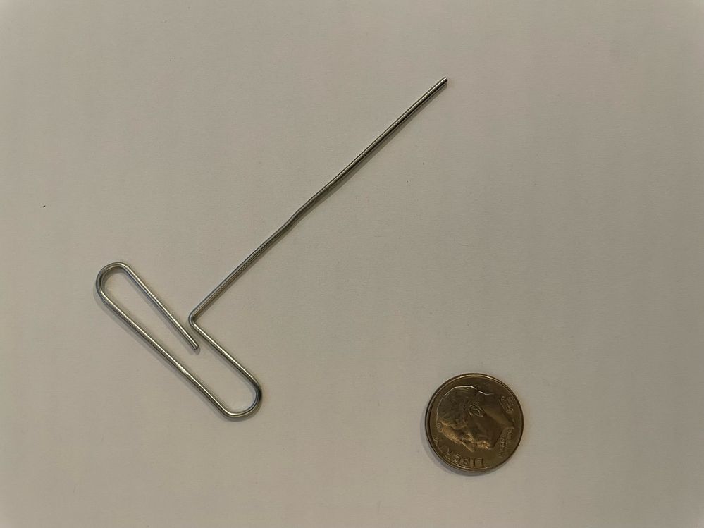

For the factory reset procedure, ensure accessibility to at least ONE Access Point (AP) to initiate the reset process by pressing the reset button located on its rear side. Utilize a paper clip for this purpose. Refer to the instructional video from the timestamp 3:30 minutes onwards to learn the process of dismounting the AP from the ceiling:
