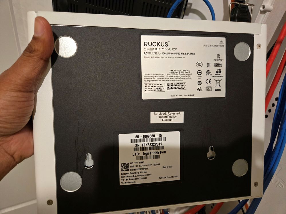

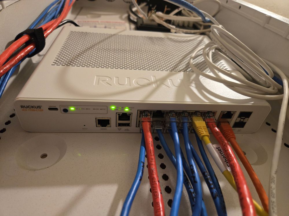

2. When your switch is connected to the outlet, do you observe any illuminated lights (amber or green)? Kindly describe which lights are visible. Additionally, please provide a photo showing the status of the lights and the full switch panel with cable connections to the switch ports.  Attached pics for your reference.

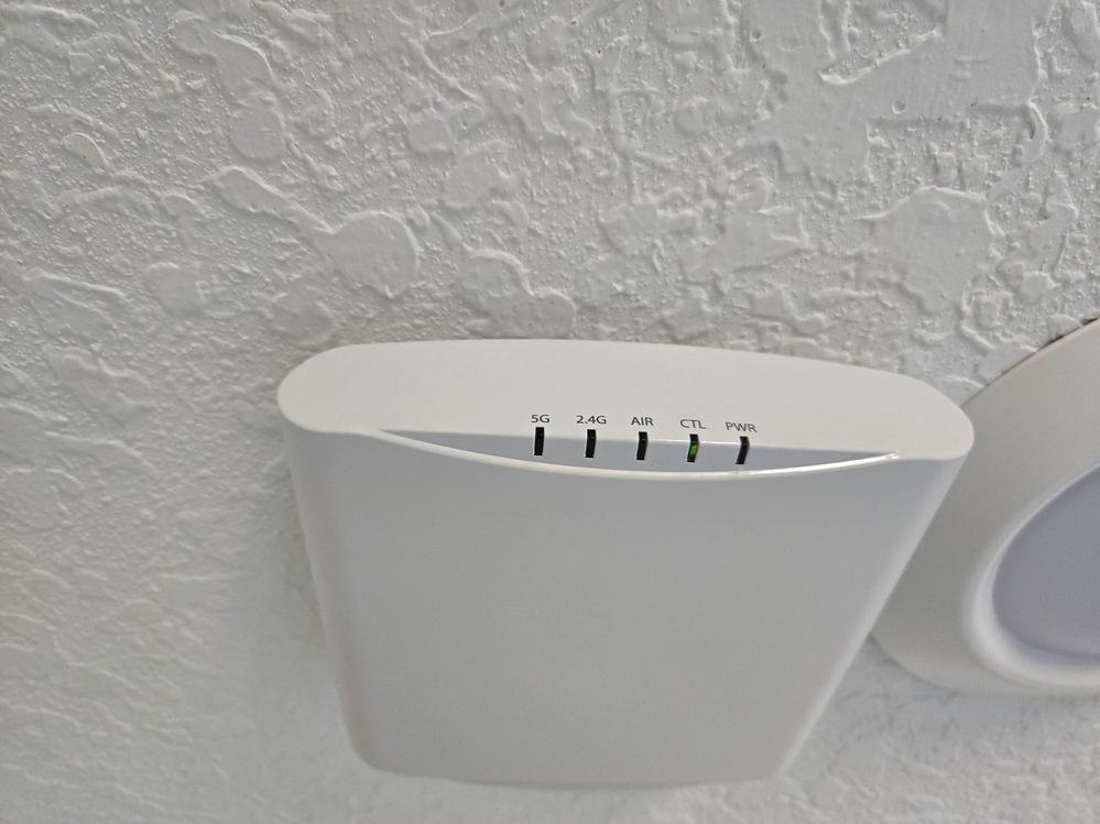

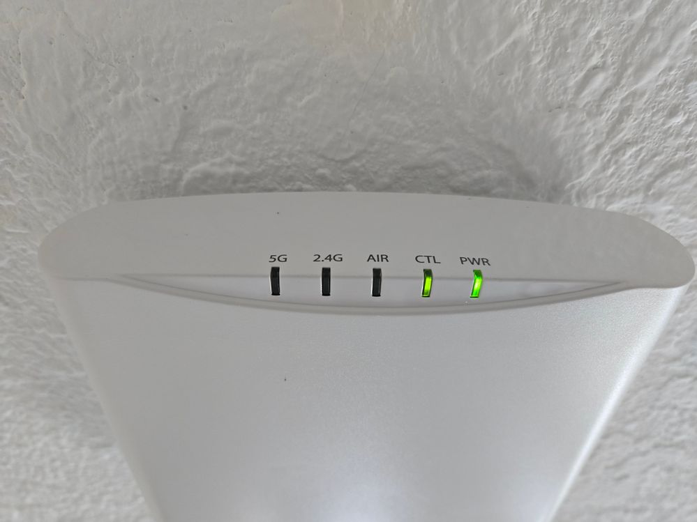

4. How many access points are currently connected to the switch? Please describe the status of the lights on the access points. Similarly, include a photo showing the access points' light status. Have two Access points

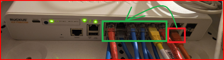

Based on the cabling and the current LED status, the RUCKUS Switch appears to be in a normal state. However, please try unplugging the Access Points (AP) Ethernet cables from their current switch ports and reconnecting them to any other available ports within the 1–12 range (refer to the screenshot below). Once completed, please check the functionality.
Additionally,  I see a ethernet cable plugged into incorrect ports. Please unplug them and reconnecting them to any other available ports within the 1–12 range (refer to the screenshot below). Once completed, please check the Aps and internet after sometime.
