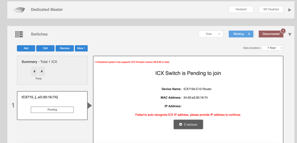

I tried logging into https://www.unleashed.ruckuswireless.com/admin and I observed that the ICX Switch(CX7150-C12) shows Disconnected.

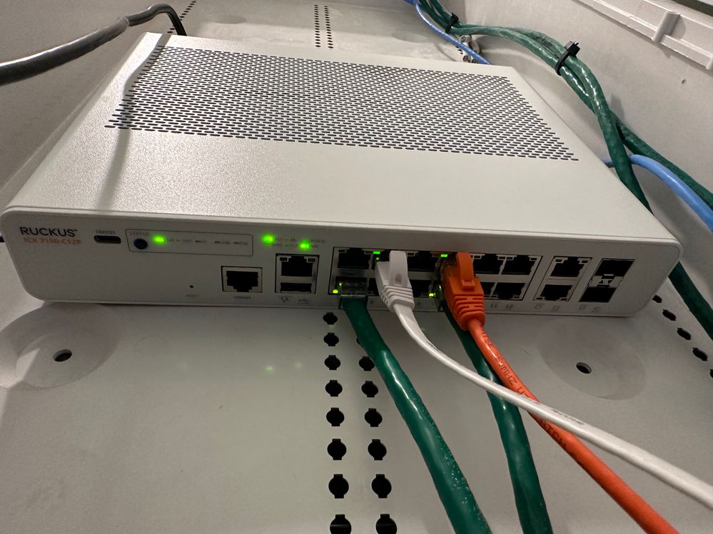

1. On your switch while it's plugged into the outlet, do you see any lights on? (Amber or green) Please let us know which lights are on. (Please refer to the below picture and share a picture of the same, showing the light status and the FULL Switch panel cable connections to the Switch ports)

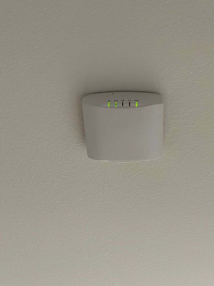

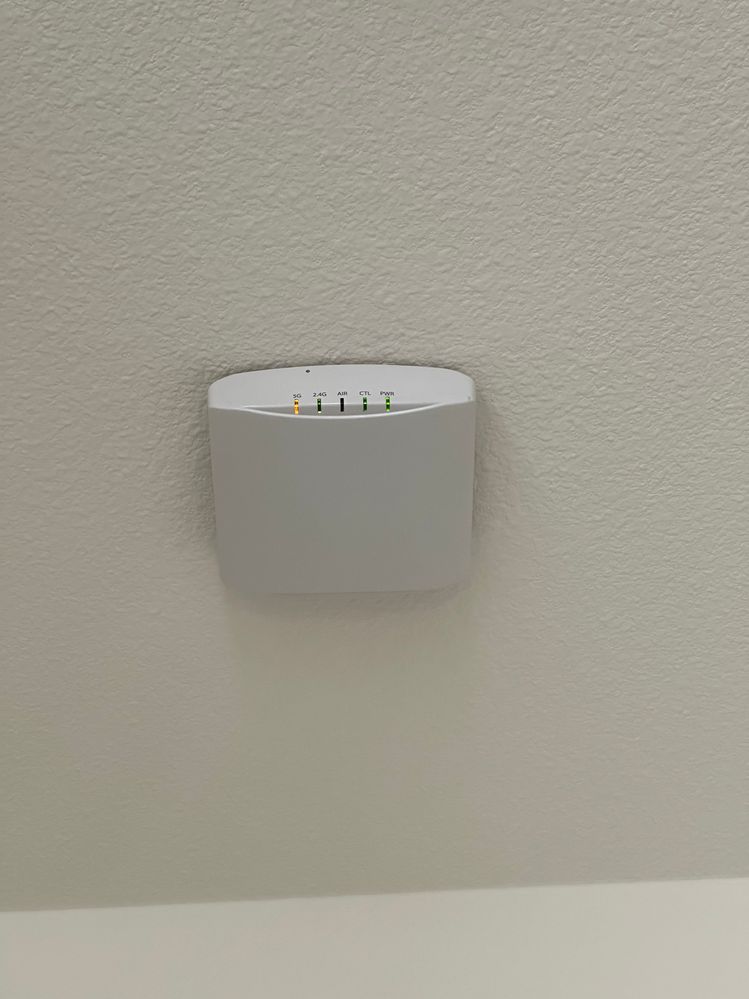

3. May I know how many Access Points are connected to the Switch? Could you please let me know the light status on the Access Points? Any of these lights are on (Please refer to the below picture and share a picture of the same)

I have uploaded all of the required images of the Switch(showing all the current lights, AP1, AP2 and current Switch status shown under the unleashed admin panel). Please find all these images below.

As per the pictures you shared, light status of the Switch and the Access Point seems to be normal.

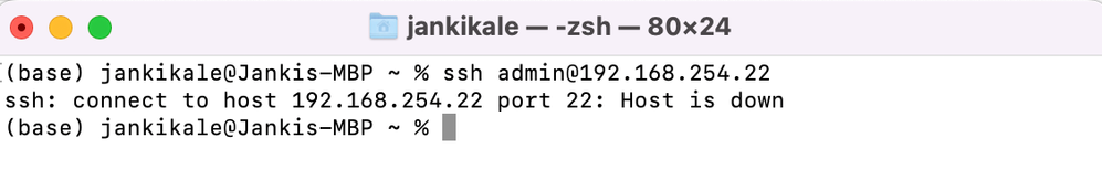

I have a Macbook and I am following the the steps given in the article you provided -- https://community.ruckuswireless.com/t5/RUCKUS-Support-for-Lennar-Homes/How-to-remotely-access-to-IC...
using command line. But its giving the error -- "ssh: connect to host 192.168.254.22 port 22: Host is down"
Please see the attached for the same.

Screenshot 2023-09-04 at 3.24.39 PM.png-Swapnil
