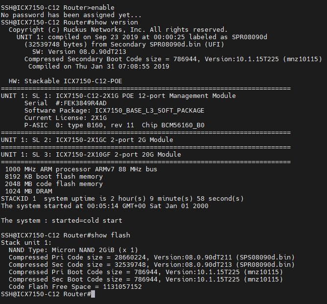

Hi @piyush2212
We may need to check some configurations on the Switch. Please follow the below steps and help me with the queries.
Please follow the below steps and help us with the queries:
ICX7150-C12 Router> OR
ICX7150-C12 Switch>
show version
show flash

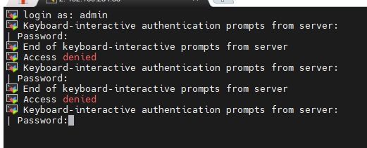

Got stuck at step 2. Mobaxterm doesnt connect. It says access denied. username and password doesnt work as it was provided to me on the sticker. (also why am I not able to attach images anymore ? - it asks image source, description, etc. )
12-19-2023 12:27 PM
Never mind. i wasnt logged in. But here is the image.

Hi @piyush2212
Could you please try to log into the Switch CLI using the default credential?
Switch default credentials will be as mentioned below.
Username: super
Password: sp-admin
If the above credentials don’t work, you can try below default credential combinations as well.
12-19-2023 01:57 PM
Here are the screenshots for the questions that you asked.
Can you guide with next steps
