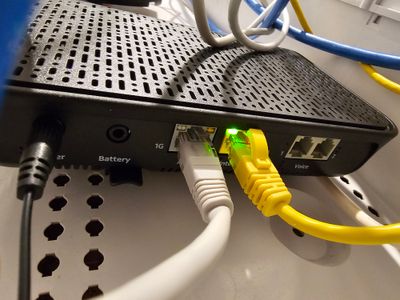

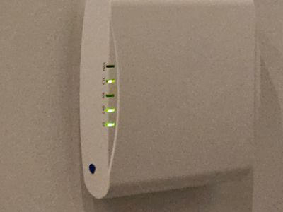

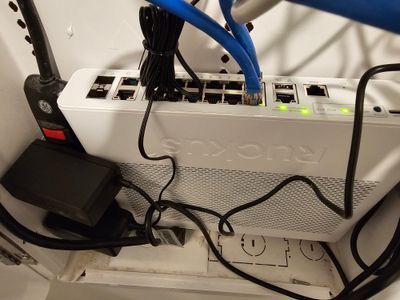

Hi Imran.  Before I can do any of the above I need to know the correct way to the plugs are supposed to be.  Spectrum kept saying its the rukus but it was actually their modem.  So I took apart the rukus so I could get some internet after they changed the modem.  However the signal from spectrumbis not strong and I need the rukus set back up. I don't know if everything is where is should be. See pics.  The 510 devices are blinking on the last light and it wasn't like this before.

Could you please let me know which is the ethernet cable connected to the RUCKUS ICX-7150-C12P Switch which is coming from the ISP’s (Internet Service Provider’s) Router or the Modem-Router combo?
If your ISP modem is directly connected to the ICX-7150-C12P Switch, it doesn’t work only with Modem. The connection must be from a Router or Modem-Router combo device. Could you please confirm this once?
