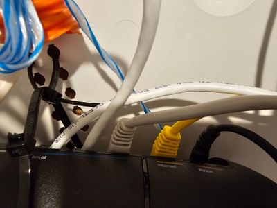

Hi Imran. Before I can do any of the above I need to know the correct way to the plugs are supposed to be. Spectrum kept saying its the rukus but it was actually their modem. So I took apart the rukus so I could get some internet after they changed the modem. However the signal from spectrumbis not strong and I need the rukus set back up. I don't know if everything is where is should be. See pics. The 510 devices are blinking on the last light and it wasn't like this before.
Thanks
10-18-2023 08:30 AM
Hi @TomJones3198
Could you please let me know which is the ethernet cable connected to the RUCKUS ICX-7150-C12P Switch which is coming from the ISP’s (Internet Service Provider’s) Router or the Modem-Router combo?
If your ISP modem is directly connected to the ICX-7150-C12P Switch, it doesn’t work only with Modem. The connection must be from a Router or Modem-Router combo device. Could you please confirm this once?
Please refer to the short guide link below about how to connect the devices as a reference:
Please check your cable connections as described above and let me know if you have any queries in this regard.
