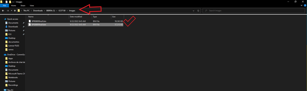

Since you are already on a version 8090d in this case 8090d you don't need the boot folder since the new versions UFI ( 8090 code or later ) version include ( everything in the image.bin file ) the fastiron OS, boot code, POE firmware, etc. all in one .bin
Check on the following guide from point '20' :
Via TFTP example:
The only file need it is the following :
Best Regards

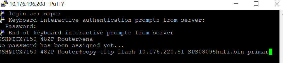

The good news is that I got the software uploaded and the system appears to be running OK, however I only have one component (a switch) and the accounts (even the super account to administrate) are not working or say no password defined (see response below). Can you advise what I need to do? Thank you ver much.
login as: super
Keyboard-interactive authentication prompts from server:
| Password:
End of keyboard-interactive prompts from server
SSH@ICX7150-C12 Switch>enable
SSH@ICX7150-C12 Switch#show version
UNIT 1: compiled on May 6 2022 at 23:24:50 labeled as SPS08095g
(31457280 bytes) from Primary SPS08095g.bin (UFI)
SW: Version 08.0.95gT211
Compressed Primary Boot Code size = 786944, Version:10.1.24T225 (mnz10124)
Compiled on Thu Apr 21 06:08:52 2022
HW: Stackable ICX7150-C12-POE
UNIT 1: SL 1: ICX7150-C12-2X10GR POE 12-port Management Module
Serial #:FEK3809S1LC
Software Package: BASE_SOFT_PACKAGE
Current License: 2X10GR
8 MB boot flash memory
2 GB code flash memory
1 GB DRAM
STACKID 1 system uptime is 11 minute(s) 16 second(s)
The system started at 23:55:40 GMT+00 Fri May 06 2022
The system : started=warm start reloaded=by "reload"
01-25-2023 01:36 PM - edited 01-25-2023 01:38 PM
Hi @slaba0815
Great to hear that your system is up and running please feel free to mark the post as successful.
What it says is that you have not assigned a password on Privileged EXEC mode.
So to go from > to #
Switch>enable
Switch#
In order to create the password use the following steps
Configure terminal
enable super-user-password pass
Where 'pass' is the password
Following example :
Switch>enable
Switch#
Switch#conf t
Switch(config)#enable super-user-password pass
Switch(config)#exit
Switch#exit
Switch>
Switch>enable
Password:
DISBALE
Switch#
Switch#conf t
Switch(config)#no enable super-user-password pass
Switch(config)#exit
Switch#exit
Switch>enable
Switch#
Best Regards
Fernando Vasquez
