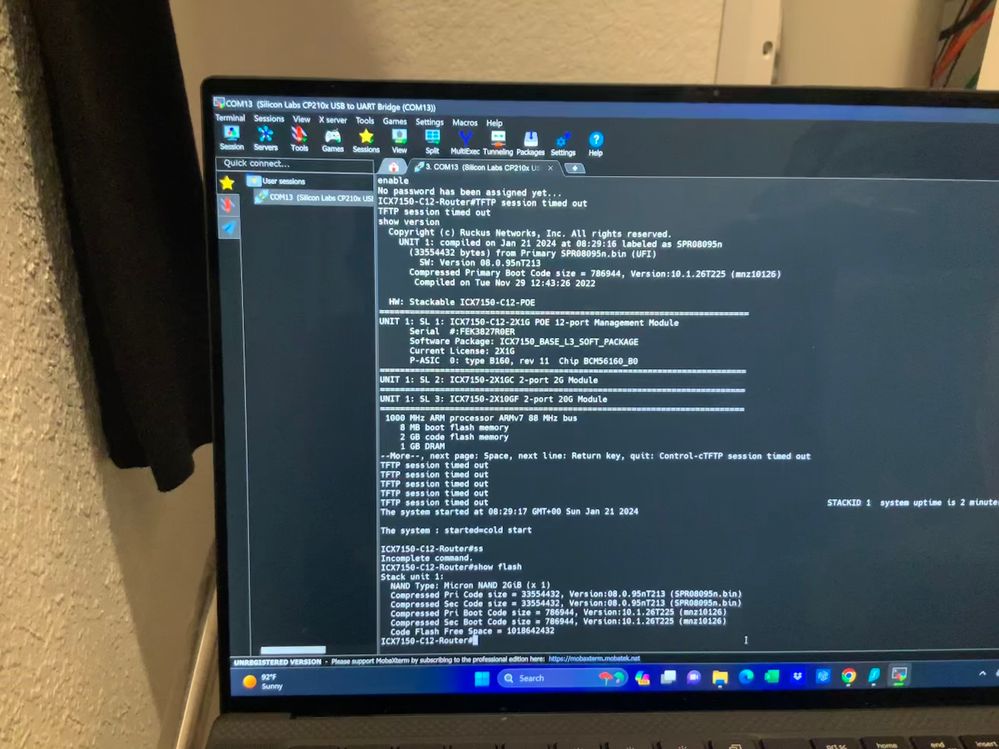

I’m having an issue with my switch box ever sense we had a power outage.

Hi @samuelsnipes
Please upgrade your RUCKUS ICX-7150-C12P Switch to the SPS Code.
For Lennar home users we recommend using the 08095g version as a stable one.
Please refer to the below RUCKUS Lennar Knowledge base self-help article for the upgrade process.
As you can Access CLI. Use 2nd option from the guide.
PLEASE NOTE: As your Switch is on a UFI version, only download the 0.80.95g file from the guide and IGNORE 08080f. You need to start from the command- copy tftp flash <tftp ip> SPS08095gufi.bin primary (Refer to the guide for more information.)
05-28-2024 10:44 AM
After I flash SPS0895gufi.bin to the primary will I also copy this to the secondary? (copy flash flash secondary)
05-28-2024 10:53 AM
Hi @samuelsnipes
Thank you for your response.
Indeed, please execute the command 'copy flash flash secondary' to copy the flash onto the secondary partition.
This step should be performed after booting up the primary partition on 08095g using the command 'boot system flash primary', as outlined in the guide.
Should you have any inquiries regarding this process, please don't hesitate to reach out.
Once again, thank you for your patience and understanding.
